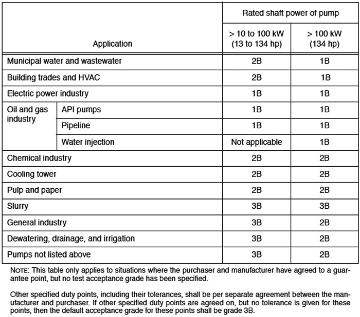

The purchaser and manufacturer must agree on a specific grade to use and judge if a particular pump will meet a guarantee point. If no acceptance grade is specified, the standard reverts to the default test acceptance grade in Table 14.6.4.
Table 14.6.4. Default acceptance grade based on the purchaser’s intended service

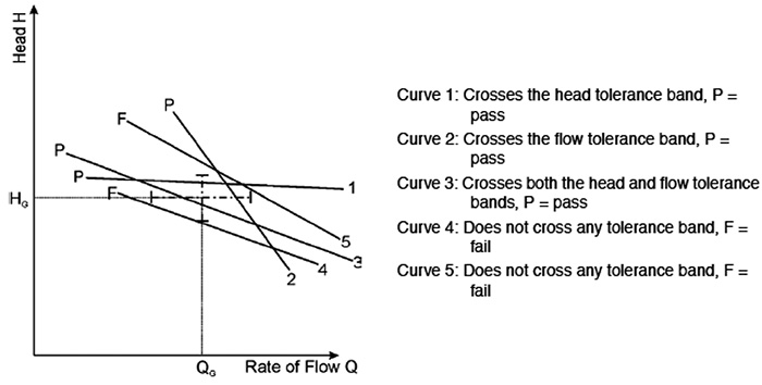

An evaluation of flow, head, power and efficiency will be conducted. Guarantee point evaluation shall be performed at the rated speed. To determine whether a pump meets the acceptance criteria, a plot of pump total head versus flow is produced and measured against the corresponding tolerance bands for the specified acceptance grade. The guarantee point for acceptance is defined as flow and head for one set of conditions. In a similar fashion, the efficiency and power plot versus rate of flow are produced and measured against the tolerance bands for the specified acceptance grade.
This new standard explains how to use tolerance bands to determine if the pump meets the acceptance criteria. Agreements should be reached between the buyer and seller as to the amount of uncertainty allowed for acceptance.

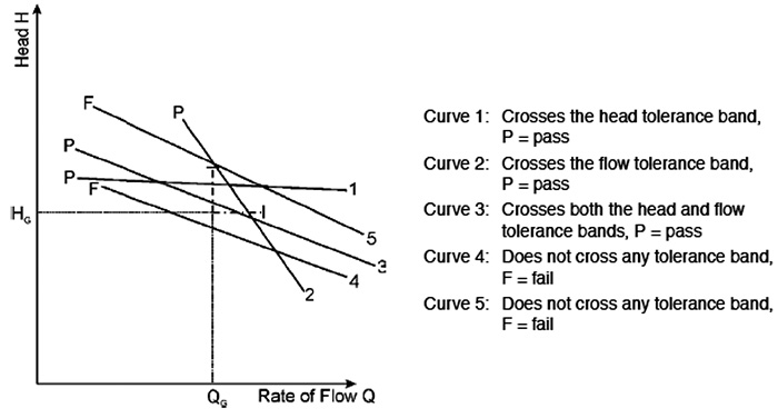

Depending on the acceptance grade, the tolerance bands can be unilateral or bilateral, with those tolerance lines forming a cross. As long as the pump head capacity curve passes through at least one of the arms of the cross, pump performance is acceptable.
For a unilateral tolerance band, only two hash marks label the limits of the length of two arms for the capacity curve to pass through, not allowing for negative tolerances. With a bilateral tolerance band, four arms are available for the capacity curve to pass through, allowing for positive and negative tolerances.
Figure 14.6.3.4.2a. Unilateral tolerance acceptance
The hash marks on the horizontal head line represent the limits of flow tolerance, while the hash marks on the vertical flow line represent the limits of head tolerance. For the curve to successfully meet the acceptance criteria, it must pass through the line and not the hash mark. See Figure 14.6.3.4.2a for some unilateral and bilateral acceptances.
Figure 14.6.3.4.2b. Bilateral tolerance acceptance

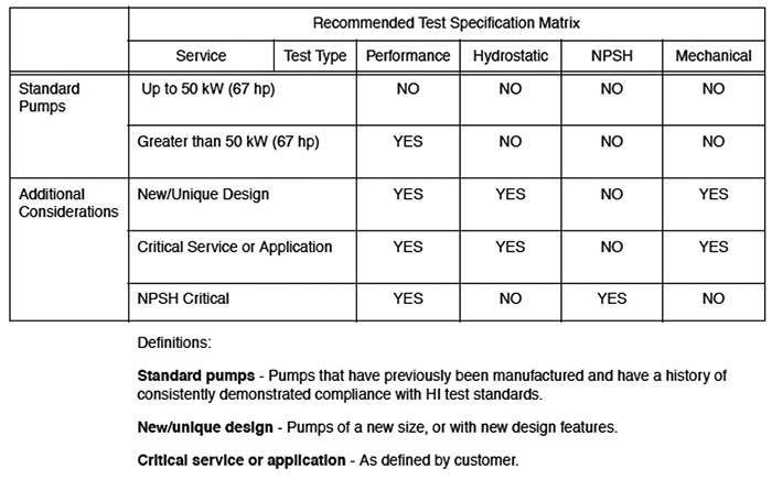

A section describing recommended tests, other than acceptance tests based on pump flow and head delivered, has been included in the new standard. This section is located in Appendix D and includes information on test types based on pump type. The types of tests include performance, hydrostatic, NPSH and mechanical. Table D.1 (from Appendix D) is a guide when determining additional testing for the pump.
Table D.1. Matrix of recommended tests

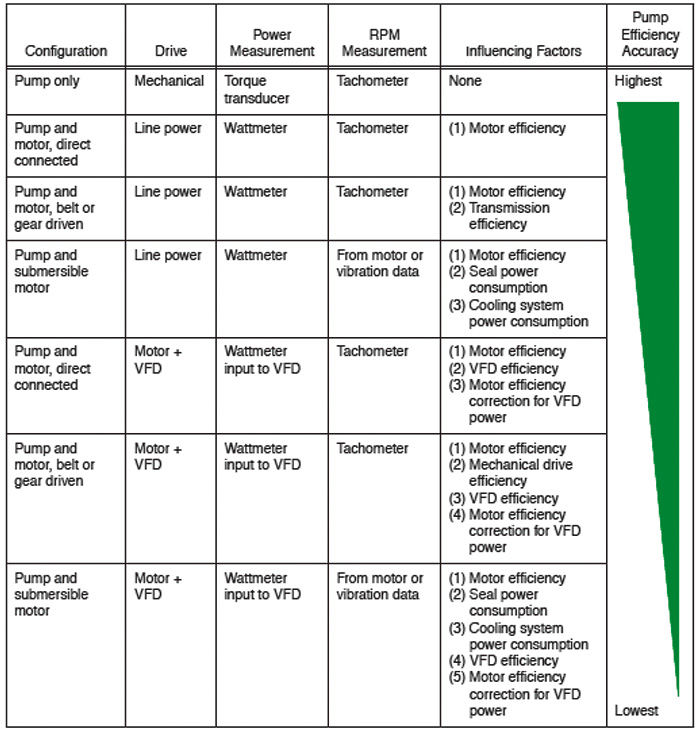

Another important addition is Appendix G (string test), which covers performance testing of the entire pumping system—including the motor, pump and drive (for example, gearbox, belt drive, etc.). This is a less accurate method of determining the true pump efficiency, since the input power to the pump shaft is calculated by accounting for the published motor and drive efficiencies. Since these efficiencies are not known precisely, this method of calculating pump input power is less accurate than when the shaft torque and rpm are directly measured.
Table G.1. Influencing factors for calculating pump efficiency for different configurations
When a variable frequency drive (VFD) is used as part of the string, obtaining an accurate value of input power to the pump shaft becomes difficult. Although many VFDs provide an output power measurement, the value of this power is approximate and usually not accurate enough for acceptance testing. This reading also does not account for the reduction in motor efficiency when operated on VFD power. Table G.1 can be used to compare influencing factors for calculating pump efficiency for string test configurations.
