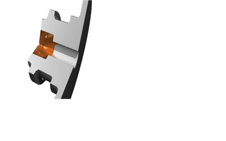

One design to mitigate effects of dirty air uses orifices made of sapphire, which is actually grown around a pin to the required size, instead of machined steel orifices (Figure 1). This material is perfectly smooth and essentially frictionless, so no machining is necessary. Standard steel machined orifices have small tooling grooving present to which the particulate can adhere. The walls at the air entry point offer another potential site for dirt buildup. That area was designed to create a much larger space for incoming air, significantly reducing the possibility of moisture-laden dirt collecting on the walls and altering the air flow.
Figure 1
More than a quarter million instruments are in use today with sapphire orifices with few reported failures worldwide due to dirt buildup in the instrument since 2007.

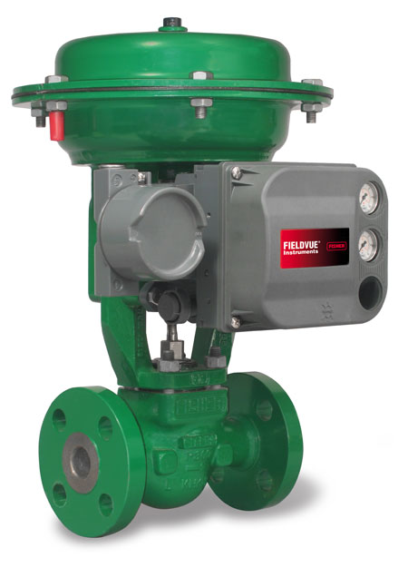

An even better solution is to remove that linkage altogether, replacing the mechanical connection with a linkage-less non-contact magnetic type of feedback element. Wear is eliminated while valve position accuracy is retained. A substantial number of DVCs (Figure 2) are currently operating in the field using this technology.
Figure 2
