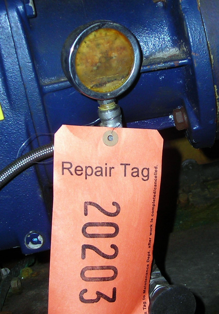

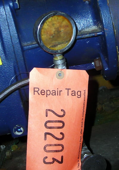

Typically, vibration is the main cause of pressure gauge failure in process plants. Pump applications produce most of the vibration that affect gauges. Pumps are also responsible for spikes and over pressure—both of which shorten gauge life.
A gauge tagged for repair after an instrument review
When it comes to gauge failures, though, pumps are not the only culprits. Sometimes, gauges fail prematurely because they are misapplied or because of unintentional damage. A gauge may have been ideal for the application when it was installed. However, if equipment modifications or additional components change the process parameters, the gauge may no longer be right for the job.
Improper installation usually damages the gauge. Pressure gauges should be installed using the proper size wrench on the flats. Note that gauges should never be installed by turning the case.
