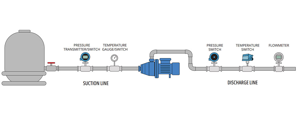

Two common locations for instrumentation in a pump system are the suction line leading into the pump and the discharge line out of the pump. These locations give useful insight into the overall health of the pump. The suction line parameters indicate whether the flow and pressure leading into the pump is sufficient.
IMAGE 1: Pump system instrumentation layout (Images courtesy of United Electric Controls)
On the other side, discharge line parameters show if the pump is producing enough pressure or if there are any blockages. More key locations include the pump motor, fluid tanks and system piping. Image 1 shows a simple pump system layout with common instrumentation locations.

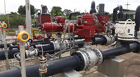

The purpose of a pressure switch, gauge or transmitter is to gain insight on the pressure levels of the media before and after it enters the pump. A pressure transmitter provides continuous measurement by sending a signal to the control system, while a pressure gauge gives local indication only. A pressure switch has the capability to shut the pump down if pressure becomes too high or low. It does this either by communicating with the control system, or directly if wired to the pump. There are also hybrid devices that operate as a pressure switch, gauge and transmitter all in one.
Pressure instrumentation used in a pump system can be seen in a water supply pump that feeds into a building. As water taps within a building open, the pressure sensor detects that pressure is decreasing. A signal is sent to the pump control system, causing the pump to speed up.
IMAGE 2: Pressure switch installed on pump system
When building water usage decreases and the pressure rises again, the pump is told by the system to slow down. If there
is a leak, the pressure will suddenly decrease. Once it falls to a predetermined set point, the pressure switch will shut down the pump and activate an alarm.

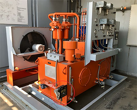

An example of temperature instrumentation being useful is on a lubrication oil pump. A temperature switch is used to monitor the temperature of lubrication oil and prevent pump damage. The temperature switch is placed on the inlet line of the system, and if oil temperatures become too hot or too cold, the switch will turn the pump off. If lubrication oil becomes too hot, it thins out and can be damaging to the pump and bearings due to lack of lubrication. On the other hand, if lubrication oil is too cold, the oil becomes too viscous and can overwork the pump motor while trying to provide the proper flow. This application and temperature switch are shown in Image 3.
