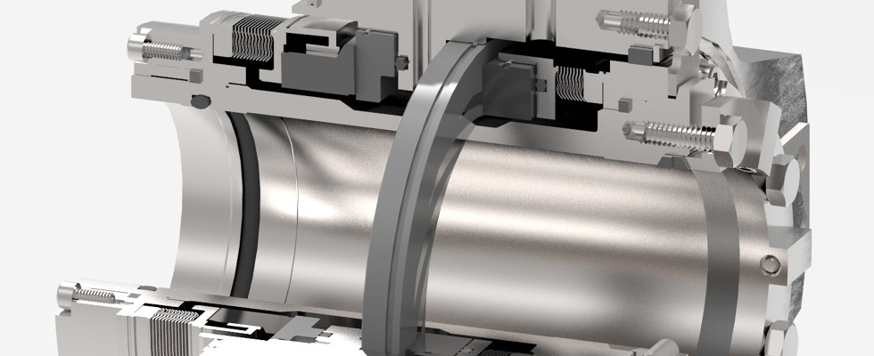

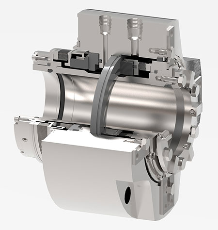

Technology
Noncontacting seals are self-contained, preassembled metal bellows cartridge seals that do not require centering or measuring during seal installation. The seal designs can comply with API 682 design requirements for reliable process containment. Dual gas-lubricated seals differ from other pressurized multiple seal arrangements in that they do not have circulation of a fluid between the inner and outer seals but rely on an external source of an inert barrier gas to pressurize the barrier cavity. The pressurized gas barrier functions to prevent leakage of the process fluid to the atmosphere as well as to lubricate and cool the seal faces.
The minimum seal support system required for proper operation of these seals is an API Plan 74. Typically, the external source of barrier gas is a pressurized nitrogen line within the plant and applied to the seal with a pressure greater than the process pressure being sealed. An inert gas is recommended.
The principles of operation are based on a seal face that has a topology applied to it, such as a spiral groove, and are designed in such a way to generate both hydrostatic and hydrodynamic “lift.” The seals rely on a thin, stable film of gas between the sealing faces. When the pressurized barrier gas is applied to the seal and the shaft is rotating, a band of high-pressure barrier gas is created between the seal faces. This separates the seal faces and creates a noncontacting dynamic seal with no friction, no wear and no cooling requirements.
Metal bellows primary seals are required since they utilize static flexible carbon graphite secondary seals, which are inert and can handle a wide range of high- and low-temperature applications effectively. The metal bellows assembly also allows for modest axial displacements while maintaining sufficient face load to provide a high level of performance in sealing high-temperature applications.
Because these seals are often used in corrosive, high-temperature services, the materials of construction are all Inconel metal bellows with either silicon carbide, silicon carbide/graphite composites or tungsten carbide seal faces. Seals’ faces can be designed to be pressure balanced so they can handle full reverse pressure.
