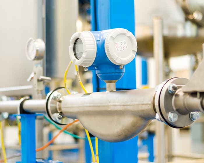

Most pumps already have (or should have) a flow meter to monitor pump discharge flow rates. Pumps also need a differential pressure (DP) instrument and a temperature instrument. A DP instrument can monitor the suction and discharge pressure—i.e., the differential pressure—of a pump. Too high or too low suction and discharge pressures can cause or indicate various pump issues such as cavitation, loss of flow, mechanical failure, vibration issues, excessive noise, or bearing and sealing wear. And some newer electronic DP devices have built-in temperature measurement capabilities (see Image 1). Temperature instruments can measure pump, fluid and motor temperatures. To avoid cavitation, the net positive suction head (NPSH) available must be greater than or equal to the NPSH required with a safety margin. Monitoring the suction head identifies conditions that can damage the pump.Several factors can change the NPSH required, including increases in flow rate and changes to the pressure or liquid level in a supply tank in front of the pump. “Smart” flow meters are available that can diagnose problems such as entrained air, vibration (which could be caused by pump cavitation), coating, corrosion and inhomogeneous or unsuitable media (see Image 2)..jpg)
