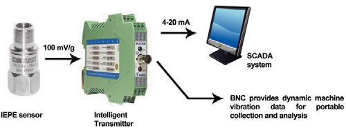

Loudon Water chose to implement simplified continuous pump monitoring that interfaced with its existing SCADA system. Four separate motor/pump combinations at a single remote pumping station were chosen for monitoring. Three pumps were impeller between bearing pumps. The remaining unit was an overhung impeller pump. For maximum protection, permanently installed accelerometers were mounted on the inboard and outboard bearings of the motor and pump. Because of its broad application potential, general purpose (100 mV/g) industrial accelerometers were chosen. The signal was then fed to DIN rail mountable intelligent transmitters. These vibration transmitters were housed in an enclosure local to the machine. This provided a termination point for the vibration signal conditioners, power supply and cables as well as a means of determining present condition at the machine.
Each of the 16 general purpose sensors captures a unique signal from its bearing location. The sensor signal is forwarded to a dedicated intelligent transmitter where the time domain signal from the accelerometer is processed into a 4-20 mA signal. This 4-20 mA signal, which represents the overall vibration velocity, is then tied into the water authority's existing SCADA system. The result is 24/7 online vibration monitoring at the pumping station with both local and remote monitoring capabilities. Loudon Water chose an intelligent transmitter because it includes a 4-20 mA output signal for simple trending and a front-panel BNC connector to access the dynamic data when additional vibration analysis is needed.
