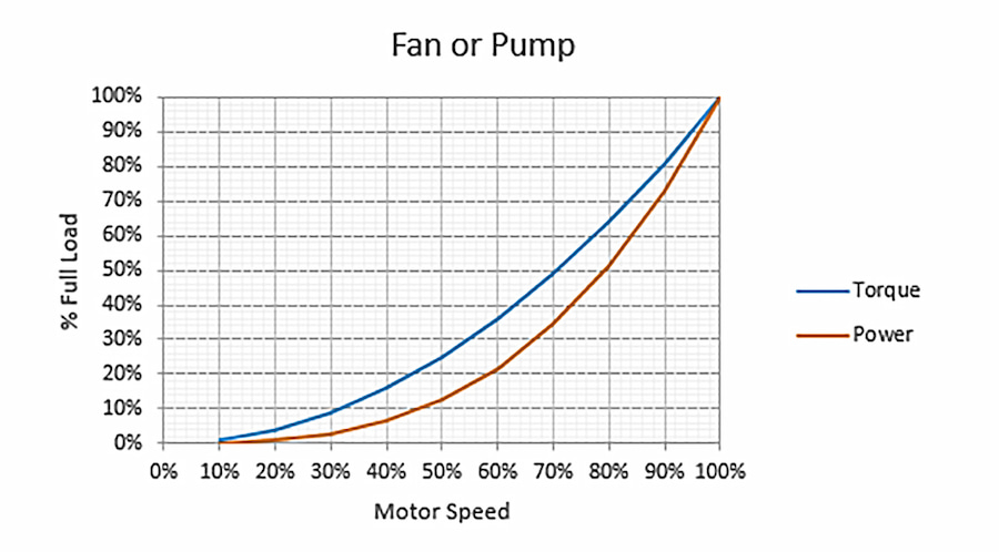

IMAGE 1: Fan or pump efficiency (Source: inverterdrivesystems.com)

First, one motor system can address several speed ranges, reducing the need for a more varied product line. Second, the relationship between the speed and power of a pump needs to be considered as it follows a cubic power curve. The flow is proportional to the speed. If the system runs 10% slower, it provides 90% flow.
Also, the torque is proportional to the speed squared and the power is proportional to the speed cubed. As a result, slowing the pump by 10% reduces the power used to 73% of full power. Assuming this is appropriate for the application, it can provide even more savings.
