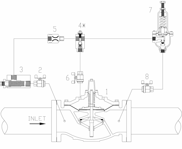

Pilot Sensing
How does the pilot actually sense the pressure downstream to accurately detect what it needs to do to control the pressure? Looking at how a typical pressure reducing pilot valve is installed on the valve, can show how this is achieved. Note in Figure 1 how the reducing pilot is connected to the downstream side of the control valve.
Examine the pilot itself in Figure 2. Internally, the downstream chamber is exposed to downstream pressure (light blue section), and this area interacts with a spring by way of a diaphragm in the pilot.
If the pressure in the downstream zone is greater than the spring setting, it forces the diaphragm upward and carries the inner valve yolk assembly, closing off the flow from the inlet to the outlet of the pilot. As the pressure in the downstream zone falls, the spring force is now greater than the pressure, so the spring forces the inner valve stem downward, opening the flow from the inlet to the outlet of the pilot, which opens the main valve.
Therefore, this effective diaphragm area and the accurate sensing are key to getting a stable pressure downstream. With that in mind, having this pilot directly connected to the body tapping on the downstream side of the main valve is not ideal.
Outlet body tappings of control valves typically fall into a distance range of 0.5 to 0.75 pipe diameters downstream of the valve seat. This means that the typical pilot senses turbulent water as it leaves the valve’s seat and is not considered laminar flow.
In a differential pressure orifice flow meter, pipe taps should be located 2½ diameters downstream of the primary element.

As shown in Table 1, the best results were achieved when the pilot was mounted five pipe diameters downstream from the valve. This is a simple change in the system that would provide greater stability to pressure management.
