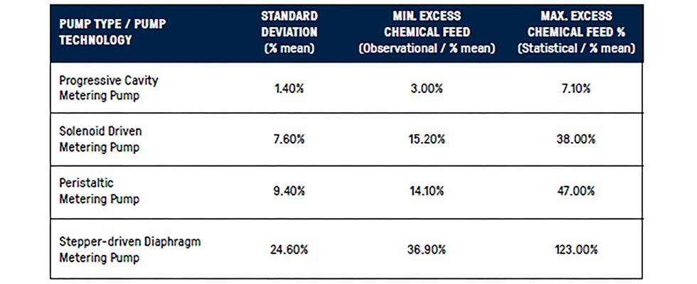

Analyzing the mean flow rate and standard deviation provides insights into pump performance and allows users to quantify the excess chemicals needed beyond the calculated set point due to design variances. This comprehensive approach aids in quantifying chemical waste attributed to pulsation, ultimately leading to more efficient and environmentally responsible operations.
The table below shows the results of recent testing done on various pump technologies. The progressive cavity pump stood out as the most efficient, wasting the smallest amount of chemicals while meeting regulatory standards. In comparison, the solenoid-driven and peristaltic metering pumps wasted five times more, while the stepper-driven diaphragm metering pump wasted over 13 times more chemicals. These results emphasize the progressive cavity pump’s ability to minimize chemical waste and enhance efficiency.
