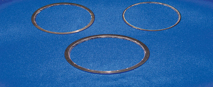

A new, composite, bulk molding compound (BMC) does not follow the age-old maxim of reducing the coefficient of friction (CoF) between the shaft and the wear bushings as a means of reducing friction/wear. Instead, the surface contact area between the shaft and the bushing is simply reduced. Wear components are molded from the compound and filled with soft, strong fibers and round, ceramic spheres. The perfectly round and smooth ceramic spheres protrude from the surface of the molded part and only a small area of the surface of each sphere actually makes contact with the shaft instead of the entire molded bushing.

Kevlar and ceramic-filled wear bushing components machined to (+/-) 0.001 inches (0.254 millimeters)
