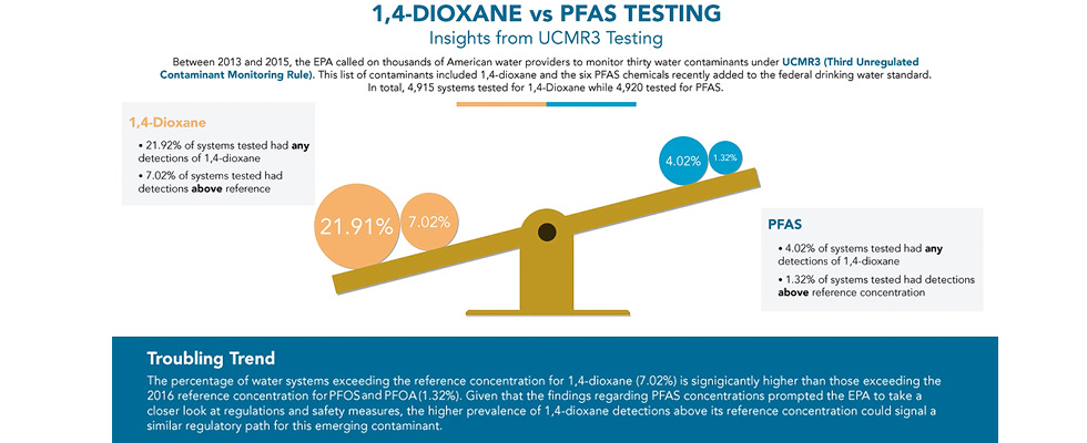

The contamination of groundwater and surface water in the United States from 1,4-dioxane is extensive. Between 2013 and 2015, the Environmental Protection Agency (EPA) called on thousands of American water providers to monitor thirty water contaminants under the Third Unregulated Contaminant Monitoring Rule (UCMR3). This list of contaminants included 1,4-dioxane and the six per- and polyfluoroalkyl substance (PFAS) chemicals recently added to the federal drinking water standard.
Among the 4,915 public water systems tested for 1,4-dioxane, 1,077 systems (21.91%) detected it in their water and 345 systems (7.02%) reported concentrations above the EPA’s reference concentration of 0.35 parts per billion (ppb), the threshold considered hazardous to human health. The highest 1,4-dioxane detection was 34 ppb.
As a comparison, that same study found 198 systems out of 4,920 participating water systems (4.02%) detected PFAS, with 65 total systems (1.32%) reporting perfluorooctane sulfonate (PFOS) and perfluorooctanoic acid (PFOA) levels above the 2016 reference concentration of 70 parts per trillion. Considering that the PFAS findings prompted the EPA to set regulations and safety measures for PFAS, the higher prevalence of 1,4-dioxane detections and its health risks could signal a similar need for regulatory action.
