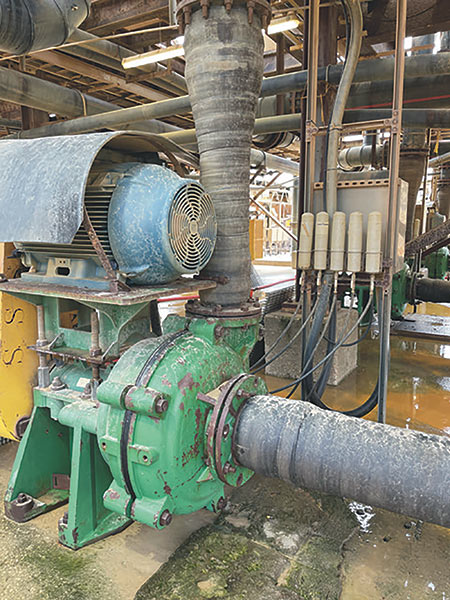

Case Study: Slurry Pumps in Frac Sand Production
A recent installation at one of the largest frac sand producers in Texas demonstrates the impact of intelligent lubrication on pump system reliability. Producing over 3 million tons of frac sand per year and loading 15,000 tons per day, this facility uses centrifugal slurry pumps to move material throughout the production process.
Prior to implementing an intelligent lubrication solution, the facility employed a full-time staff member dedicated solely to the manual greasing of pump bearings. Despite best efforts, the employee could not keep up with the demand to protect the bearings from high levels of water and corrosive material ingress. The consequence was severe—slurry pumps were failing every two weeks due to contamination, costing approximately $120,000 in materials, labor and lost production per failure.
After evaluating the options, plant management chose an intelligent, automated lubrication system and installed 34 lubricator units on 11 critical pumps. These units were configured to deliver precise amounts of lubricant at optimized intervals, with connectivity to a condition monitoring platform that provided remote visibility into lubricator status and easy inventory management.
Since installation over a year ago, the facility has not experienced a single pump failure, an unmitigated success compared to the previous failure rate of two weeks. The financial impact was substantial, with documented annual savings of $1,731,440 in materials, unplanned downtime and labor costs. This success eliminated dedicated manual greasing efforts, improved on-site safety and prompted plans to expand the system to all pump bearings throughout the facility.
