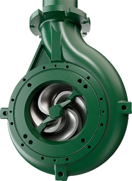

Chopper pumps are centrifugal pumps equipped with chopping features that reduce the size of solids in various waste streams—including municipal sewage, food waste, industrial waste and agricultural waste. These pumps employ sharp impeller vanes that rotate past stationary cutter bars at the suction inlet, effectively chopping solids before they are pumped out.

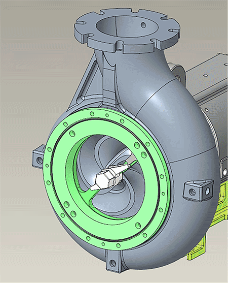

Prior to CFD, pump design was often based on theoretical calculations and limited by manual prototype testing. Design iterations were minimal due to the expense of casting and machining unique parts. Rapid prototyping via 3D printing, which became more accessible around 2010, has helped—but even today, large-format prints or casting patterns remain costly.
Because of CFD, engineers can now simulate dozens of impeller geometries, volute shapes and suction configurations virtually, before investing in a single physical part. However, CFD is only as good as its real-world validation. Over time, manufacturers developed precise modeling techniques and mesh strategies to ensure simulation results accurately predicted physical pump performance.

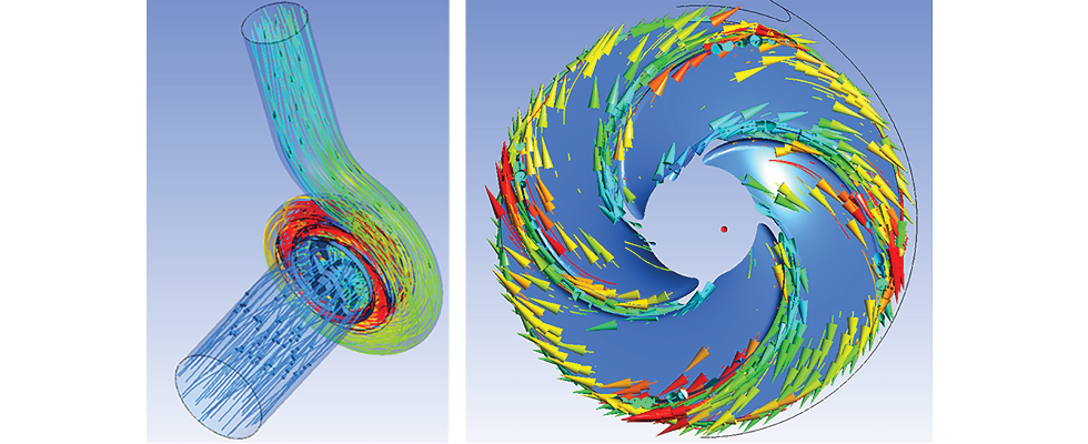

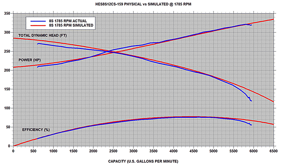

One pump manufacturer that has been using CFD modeling combined with rigorous testing and validation work for over 22 years has found it allows them to design new pump models with CFD simulations matching real laboratory results to within a few percentage points. This level of accuracy—achieved through repeated refinement and empirical correlation—has allowed new pump designs to move confidently from simulation to production.
Since standard pump performance testing uses clear water, CFD simulations do the same. While this may seem limiting, decades of experience with chopper pump applications allow engineers to design blades that balance cutting efficiency and hydraulic performance based on CFD data and field knowledge.

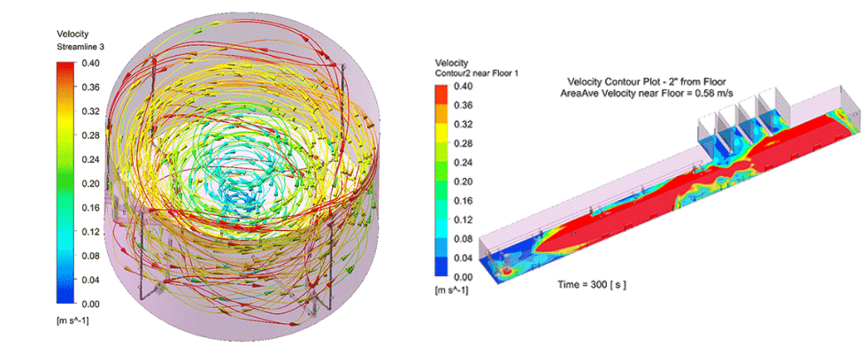

CFD is indispensable in designing effective hydraulic mixing systems. Early simulations revealed how nozzle placement, angle and velocity affect flow patterns and fluid velocity distribution within tanks. This understanding helped engineers develop tailored mixing strategies for cylindrical, rectangular and irregularly shaped tanks.
One of the most powerful benefits of CFD is its ability to “look inside the tank.” Traditional field testing relies on limited sampling at discrete points, which may not reveal complete flow patterns. CFD simulations offer comprehensive visualizations such as:
- Velocity contour maps
- Streamline paths
- Tracer concentration over time
These tools help engineers understand how a fluid (or added tracer) moves through a tank, how it reaches the suction inlet and how quickly it recirculates through the system.

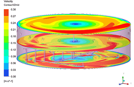

For example, simulating a tracer burst in a digester tank allows engineers to visualize mixing patterns, identify dead zones and detect short-circuiting between inlets and outlets. These insights guide nozzle placement, feed and withdrawal locations, pump sizing and control strategies, leading to more effective and energy-efficient systems.

Simulations have shown that reaching steady-state conditions in large tanks, such as anaerobic digesters, can take up to an hour or more. Understanding this time-dependent behavior helps set realistic expectations for system performance and commissioning.
Accurate simulations require detailed modeling of internal tank geometry, including columns, corbels, existing piping and obstructions. These features can significantly influence mixing energy distribution and localized flow conditions.

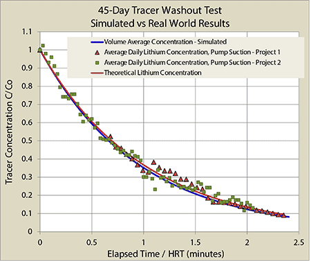

Tracer washout simulations have been invaluable for validating real-world mixing. By simulating a tracer’s movement through a tank—from injection at the pump suction and mixing nozzles, or from another feed location—engineers can compare simulated washout patterns with actual operational data, such as digester feed and bleed cycles.
The strong correlation between simulated and observed tracer behavior reinforces CFD’s role as a predictive tool. Video footage and visual observations over the years have consistently mirrored the simulated velocity vectors and surface flow paths, lending confidence to design decisions based on CFD outputs.
