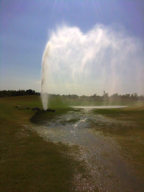

| .jpg) |
| Geyser on Green 17--damage can occur if a leak in a remote area goes undetected and the water is not shut off immediately. Photo courtesy of Bailey Ranch Golf Club, Owasso, Okla. |

When a VFD pump system is running PID (constant pressure) control and the piping becomes damaged, the ideal scenario would be to turn off the pump shortly after the detection of a broken pipe. If the pump were to continue running with damaged piping at full speed and maximum gallon-per-minute volume for a long period of time, the damage that would occur from flooding could be extensive (Figure 1).
VFDs provide broken-pipe protection that will trip (shut off) the VFD when an incident occurs. Typically, broken pipe trips are designed around PID operation. The trip conditions consider the live pressure feedback from a transducer mounted on the pipe, as well as the operating state of the VFD. If all the following conditions are met, the VFD will determine that a pipe is broken:

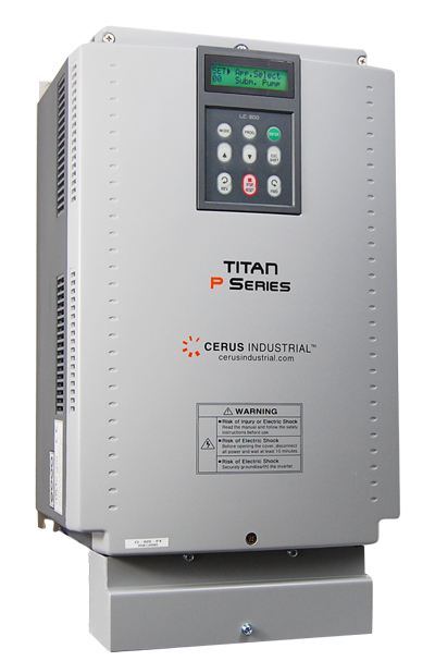

New firmware for one VFDs featuring a fast application (see Figure 2) allows for robust pipe-fill, broken pipe and under-load programmable options. Through testing and user feedback, a set of default values for these protective features are included, reducing programming time for a majority of pumping applications. Some settings include:
- Pre-PID frequency: Operating frequency for the VFD before normal PID operation
- Pre-PID exit level: Pressure level to exit Pre-PID mode
- Pre-PID stop delay: Time delay to exit Pre-PID mode
Image 2. Some VFDs contain upgraded firmware to support robust pipe-fill, broken pipe and under-load programmable options.
Some VFDs provide the ability to set parameters in application-specific units. For example, pressure set points can be entered in psi, WC, M, bar, mbar, Pa, and kPa. To set up the pipe-fill limits, users monitor the pressure with the VFD during testing and then set the appropriate Pre-PID exit level in the unit of choice.

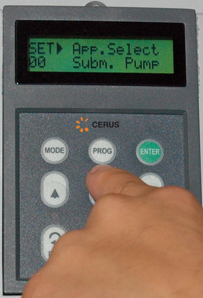

.jpg)
Figure 3. The keypad on this VFD is used to select setup options, including the units in which pressure will be displayed.
A combination of conditions is monitored for true dry pump detection, while the hysteresis option prevents nuisance trips by eliminating conditions that would cause the pump motor to cycle on and off repeatedly. For well replenishment, a well fill time option is included that sets the period of time that the VFD will deny all requests to run (more commonly used for submersible applications). After the delay time expires, the VFD will attempt to start again. With live feedback monitoring via a pressure transducer and closed-loop PID controls, VFDs have many protective/application features to offer. The pipe-fill operation, broken pipe detection, and under-load detection are part of the protective features available on VFDs. Understanding how these features work and how to program them for specific applications will provide system robustness and lengthen the life of critical system components.
