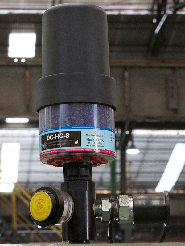

The other primary source of ingression is airborne contamination in the form of particles and humidity that contaminate the oil while in use. Installing a desiccant breather will prevent particulate and moisture from entering the application’s reservoir. It is also capable of removing water from the oil that gets in from other sources by continuously drying air in the headspace. Many plants use high-quality mechanical seals to prevent ingression from the seal and to eliminate the need for a vent on process pumps, but this may not completely eliminate ingression. At the very least, the mechanical seals will breathe while the equipment is shut down allowing significant ingression of humid air for the duration of the outage.Modifying Pumps for Precision Lubrication
Once the new oil is filtered, it must be dispensed, transferred and applied to the machine in a way that won’t reintroduce it to the environment, potentially negating the effort to get the oil clean. Equipment should be modified to remain sealed during all phases of normal operation—including routine maintenance, such as level checks and oil changes. This can be achieved by retrofitting the drain and fill/breather ports with easy-to-install modification kits that permit multiple access points to equipment without opening the sump to the environment. Any modification should allow for topping off the oil, checking the oil level, taking a sample, draining or filling the reservoir, and possibly kidney looping the oil to ensure every lubrication task can be performed without exposing equipment to the dirty plant environment.

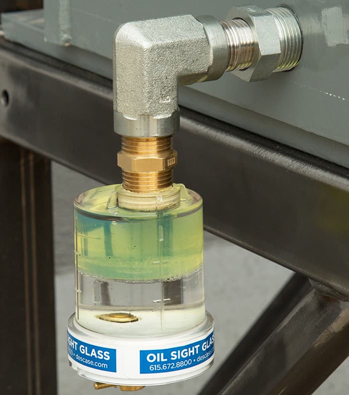

Oil sight glasses and other visual oil analysis solutions play a critical role in early detection of contamination and oil level problems. They also allow for constant monitoring of what’s happening inside equipment. The use of bottom sediment and water (BS&W) bowls allows for the draining of gross water contamination and visual level indicators eliminate the need to open the level port to check the level further preventing contamination (see Image 3).
