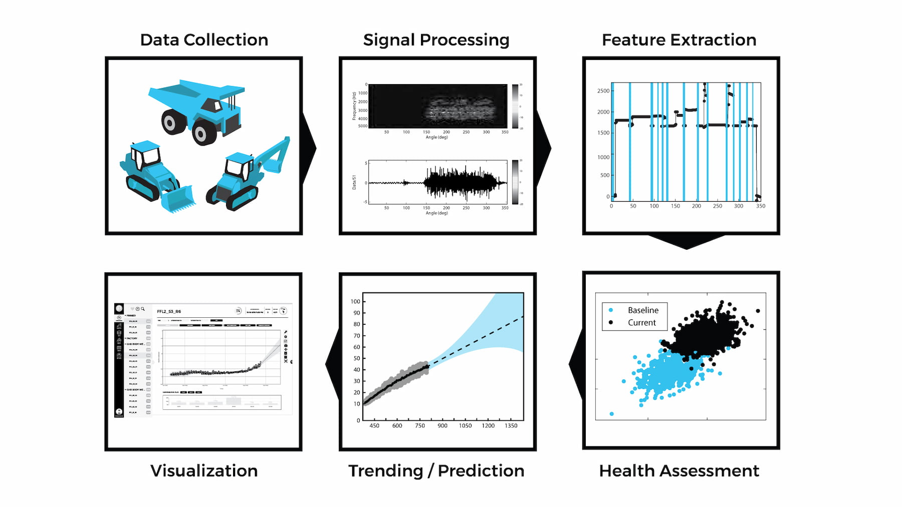

A methodology process graphic showcasing the steps from dump truck data collection to data prediction visualization (Image courtesy of Predictronics)

Sensor parameters associated with the vehicle engine, transmission and electrical system (battery) were used to configure health monitoring solutions for each of these individual subsystems. This subsystem model approach was used to streamline the analysis process, as examining all 45 signals in one model would likely yield inaccurate results and make it more difficult to interpret these results and troubleshoot. Instead, it was most logical to divide the vehicle into its subsystems for health monitoring.
Machine learning was used to generate predicted parameter values, which were then compared to actual values. The predicted sensor values are based on a machine learning model that learns the baseline values and correlation relationship in the measured signals. This allowed the company to compare the temperature, pressure and other sensor readings at different vehicle operating conditions, which was more robust than simply comparing sensor values to thresholds. This residual-based analysis approach, along with the application of additional analysis methods, was the key to identifying variations in behavior indicative of an impending failure across different vehicle operating conditions.
By using a time-series anomaly detection model, the solution was able to easily predict a faulty valve issue within the vehicle before it occurred. This faulty valve was causing excessive and unusual oscillation in exhaust temperature. A time-series analysis model is useful in these specific circumstances when the anomalous patterns are less related to changes in value and correlation, but rather a change in the time-series pattern.
