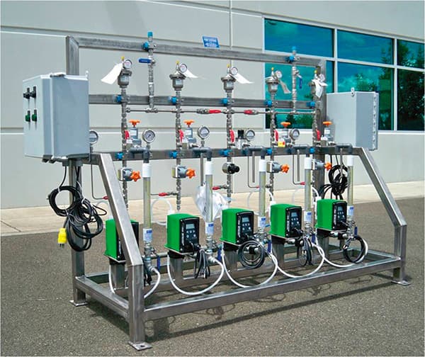

packaged dosing system
Packaged dosing system
The Importance of Packaged Dosing Systems
Dosing pumps are an important component in most large plants and systems. Several dosing pumps are often installed at a site. The key is to package the dosing systems for the greatest benefit. From the specifying engineer to the dosing system supplier, the installing contractor to the plant operator, packaged dosing systems can benefit everyone.
Packaged dosing systems have been gaining popularity during the last 10 years, but not everyone considers the advantages of packaging dosing pumps into complete systems. The advantages to specifying, supplying, installing and owning a packaged system are numerous. Dosing systems may seem complicated, but most consist of similar components and can be set up for a multitude of applications. The components of dosage systems can make the system appear more complicated. These components include:
