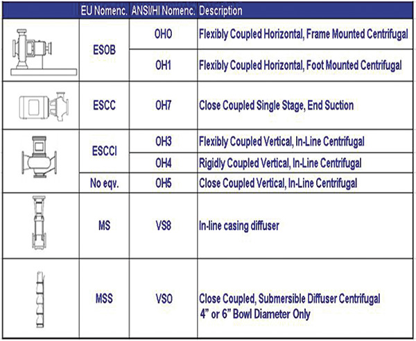

Since the DOE pump efficiency rulemaking began in early 2011, HI has advocated for a product scope relatively consistent with EU regulations. HI’s analysis of the U.S. pump market, reported to the DOE on May 2, 2013, confirmed, “that the variety of existing products and numerous market segments, each with unique requirements, is wide and complex as similar designs cross multiple market segments and are applied differently, resulting in a large number of unique product variations.” To capture the largest population of pumps that cost effectively produce the greatest energy savings, HI recommended aligning with directive EU No. 547/2012, which focuses on non-engineered/non-specialized pumps, in standard design, applied in clean-water-only applications for the broadest scope. Pump types covered by EU No. 547/2012 are outlined in Table 2 with their U.S. equivalents noted by the ANSI/HI nomenclature designation and description. HI has pressed for the use of HI standards for establishing well-understood pump industry reference documents, including pump test procedures.
Table 2. Pump types- Only standard pumps of non-engineered/non-specialized design
- Only clean water (including grey water)
- 26 gallons per minute and greater, up to a maximum 459* feet total head (H)
- Horsepower range from 1 to 200
- Pumps designed to operate in a temperature range of -10 C to +120 C *Note: 295 feet is incorrectly stated as the maximum head in the DOE framework document (see page 8 for the incorrect reference. It should be 459 feet H). Pumps and liquids specifically excluded from the scope are positive displacement, fire pumps, self-priming, wastewater (no solids-handling) and circulators.
