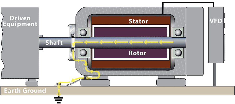

Shaft grounding rings (Image courtesy of Electro Static Technology/AEGIS)

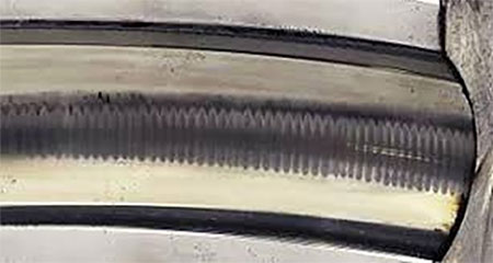

IMAGE 1: Bearing fluting caused by electrical discharge machining (Image courtesy of Nidec)
Bearing failures have increased mainly due to the fast-rising voltage pulses and high switching frequencies of VFDs. These current pulses will find the path of least resistance to ground, and that path is usually through the bearings, where the repeated discharging of these currents will gradually damage the bearing races.
Generating Bearing Currents
Bearing currents have long been an issue with alternating current (AC) motors. However, improvements in engineering, motor design and manufacturing practices have mostly eliminated the low frequency bearing currents associated with normal sine wave motor operation.
VFDs, on the other hand, typically generate high-frequency current pulses due to the rapid switching abilities of the semiconductors used in electrical conversion. These high frequency pulses cause damage and etching of the bearing and races and remove metal from the ball bearing. This metal transfers from the ball and the races to the lubricant and results in electrical discharge machining (EDM). The damage to the bearing, or EDM pit, causes a deformity in the surface of the bearing, which will draw more pulses and create EDM fluting.

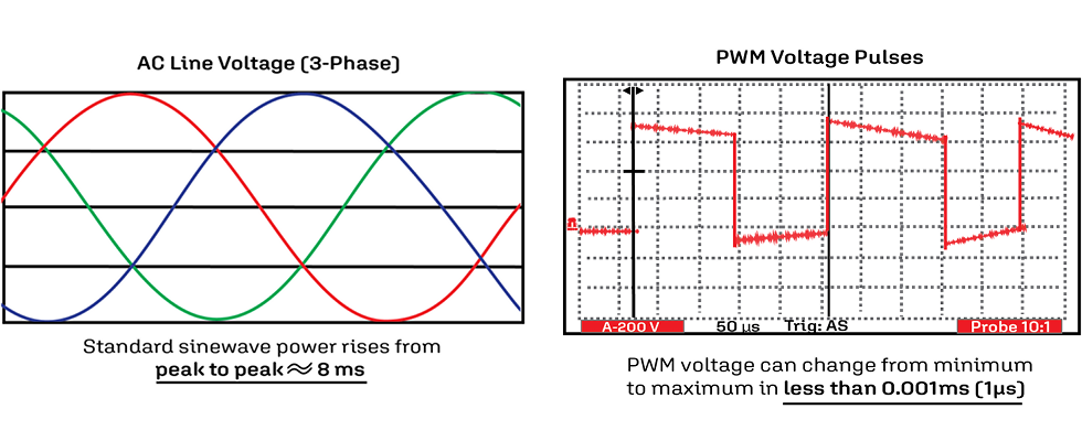

4. Common mode circuit
Under normal conditions, a three-phase power supply is balanced and symmetrical. This is not the case with a pulse width modulation (PWM) switched three-phase power supply, where a direct current (DC) voltage is converted into three-phase voltages. This voltage can be defined as a common mode voltage. The current can flow back to the source through the grounding conductor and stray capacitances of the inverter; the current flows in a closed loop that is external to   the system.
5. Stray capacitances
A capacitance is created any time two conductive components are separated by an insulator. For instance, the motor winding turn is insulated from the motor frame by enamel coating and slot insulation and has a value of capacitance to the motor frame. Modern power supplies produce fast-rising pulses that contain high frequencies. Because of these high frequencies, the small capacitances inside the motor still provide a low resistance path for current to flow. This can lead to the creation of stray currents that can damage bearings.
IMAGE 2: Charts showing AC line voltage and PWM voltage pulses (Image courtesy of Electro Static Technology/AEGIS)

The easiest way to avoid bearing damage from stray currents is to provide a path to ground that allows stray currents to return to the inverter frame without passing through the bearings. Symmetrical motor cables or inverter output filtering can reduce the intensity of the stray currents. An insulated bearing is another component that can be used to interrupt the current path.
Several solutions are available to protect the motor from high common mode current frequencies, including the following:
Grounding brushes: This method channels the current away from the bearings and significantly reduces shaft voltage and bearing current by not allowing voltage to build up on the rotor.
Insulated bearings: These bearings reduce or eliminate the path to ground through the bearing but do not eliminate the shaft voltage, which can potentially cause issues if that path is through the driven load or some other component. For this reason, grounding straps or cables are necessary.
Shaft grounding rings: These rings can be placed on either end of the shaft (Image 3).
IMAGE 3: Shaft grounding rings (Image courtesy of Electro Static Technology/AEGIS)
