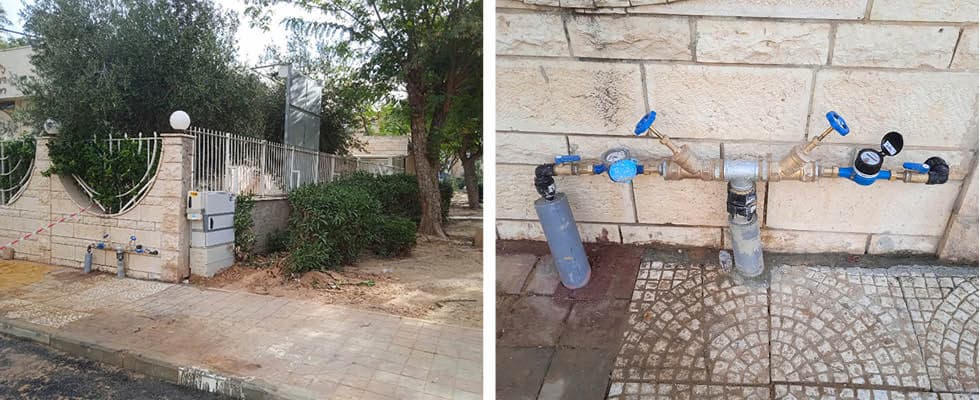

A residential home had a nice garden with a new watering system recently added by a contractor.
The main water (at 60 pounds per square inch gauge [psig]) supply pipe comes from under the ground, as shown in Image 1 (on the right). The water can go to the right (to the house) and/or to the left and under the ground, coming out further to the garden watering control valve system, which is also shown in Image 1 (at the corner of the property).
IMAGE 1: The main water supply pipe comes from under the ground (Images courtesy of the author)
