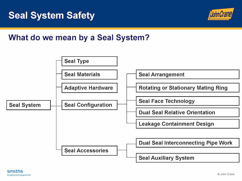

The term “seal system” refers to all aspects of the seal and its use in the pump, including:
  • The type of seal, seal materials and any adaptive hardware
  • The seal's configuration, including whether mating rings are rotating or stationary; the seal face technology; the relative orientation of any dual seals to each other, such as face-to-back, back-to-back or face-to-face; and the seal's leakage containment design
  • The seal's accessories, including interconnecting pipe work between any dual seals and the seal's support system

Sealing system components
The seal system's role in a pump is to minimize leakage of the pumped liquid from the area in the pump where the drive shaft enters or exits the casing. Depending on the type of pumped liquid, leaking fluid can be extremely dangerous, so seal systems help keep pumping equipment operating safely. Users should follow plant and local emergency response system rules when selecting a suitable seal system. Fluid can also leak from flange seals, gaskets or piping connections mounted to the casing directly or indirectly, so users should monitor those potential safety hazards as well.

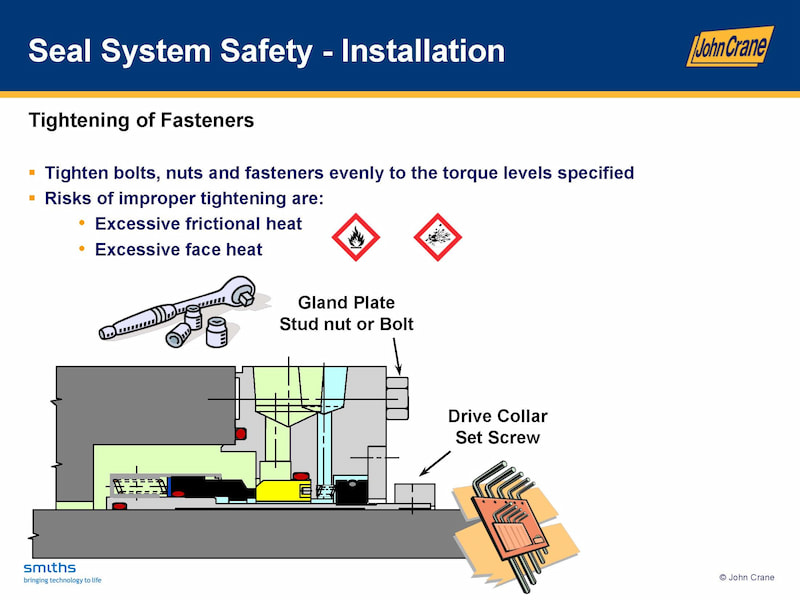

graph2
Proper fastener tightening is the first step in successful installation.

  • Tighten bolts, nuts and fasteners evenly to the specified torque levels, and fasten screws securely. Over-tightening gland bolts can create gland plate distortion, resulting in seal leakage.
