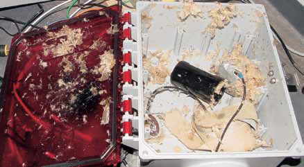

The start capacitor has a lower voltage rating than the voltage that will be applied to it from the start winding. In most instances, this is because the capacitor is expected to be in the circuit for a short period of time, and a capacitor that is rated for the full voltage would cost more money and require more space. If the start capacitor does not get removed from the circuit, the capacitor will fail because of the lower voltage rating. Often, this results in the top exploding off the capacitor spraying hot oil (300 deg F and hotter) and projectiles and exposing dangerous electrical voltages. Several situations may cause the start circuit not to open. One of the most common is a locked rotor on the pump. In this case, the pump is plugged or jammed from debris, and the motor cannot rotate. If the pump cannot rotate, it will not build up the voltage on the start winding needed to drop out the start capacitor, which will create the conditions that allow the capacitor to fail.
Failed Starter Capacitor

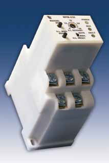

A motor power module (MPM) will soon to be available to replace the motor starter (contactor and overload) and the start relay, all in one compact unit. One of the most significant features of the MPM is that it protects the start capacitor by monitoring its usage. If its usage is excessive, the MPM will disable the capacitor for a period of time, allowing for cool-down time. Cool-down typically takes a few minutes, and then the capacitor is available for use again as needed.
Motor Power Module

The MPM combines the functions of the motor contactor, overload relay and start relay in one compact unit, which is approximately the size of a comparable standard motor contactor. This combined unit saves at least 60 percent of the panel space taken up by a traditional start circuit. One of the ways the MPM is able to provide this kind of space reduction is by using patented zero-cross technology. This technology controls the exact timing of the opening and closing of the contacts that supply the power to the motor. Without zero-cross technology, the contacts would open randomly compared to the AC voltage waveform, often causing arcing across the contacts. This normally requires larger contacts, and a larger contactor to handle the motor power. With zero-cross technology, the arcing is almost eliminated, which increases the life and reliability of the relay, while allowing the use of a smaller contactor to control the pump.
In addition to zero-cross technology, the MPM includes advanced motor protection and monitoring, and implements a Class 10 electronic overload while monitoring for under-current to protect the pump from a “run dry” situation. The MPM monitors incoming voltage and can be set to protect against a low-voltage situation either from the power line, or because too small a wire gauge was used to supply the power to the pump (causing too much voltage drop in the source feed wires).
