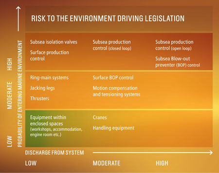

Offshore operators must also carefully consider the environmental effects of the lubricant they choose. Though demand for oil has never been greater, the pressure facing companies extracting hydrocarbons from the ground is challenging in the current environmental climate. A surge in environment-related legislation in mature production zones like the North Sea has added to the complexity of offshore production. This trend is likely to continue in the North Sea and other oil-producing parts of the world.
However, operators still must weigh reliability in their lubrication decisions. The use of an environmentally responsible product that does not at least meet conventional product performance may actually be detrimental to the environment in the long-term. If one accepts a shorter service life than from conventional oil, it may reduce the immediate impact of a spillage but may increase the overall amount of oil consumed along with its attendant packaging, shipping, storage and disposal costs-all at a cost to the environment.
If the alternative fluid is more aggressive toward elastomers than mineral oil, there is actually an increased risk of a spill or leak from the seals. It is a difficult and complex balancing act between environmental responsibility and reliability that operators must perform.
