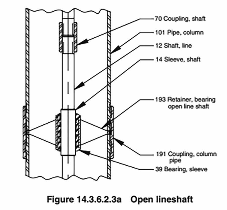

IMAGE 1: Rigid coupling on an open lineshaft (Images courtesy of Hydraulic Institute)

Rigid couplings, as their name implies, provide a rigid connection between two shafts, meaning that the shafts are connected by tight tolerances that do not allow for any misalignment. This type of coupling must transmit torsional and axial loads and is capable of the highest torque and speed ratings. Rigid couplings are primarily used on vertical pumps where the thrust bearings are located in the motor, and when used in conjunction with the driver lower bearing, rigid couplings provide pump shaft support for mechanical seals.
