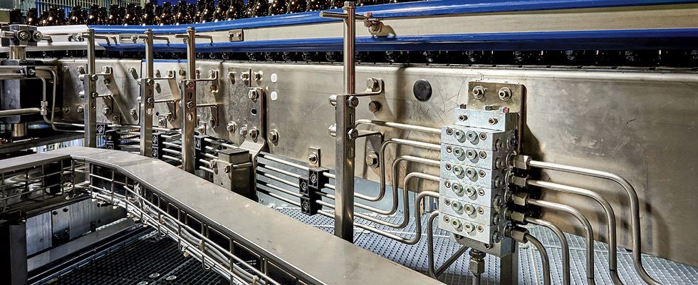

IMAGE 1: Series progressive divider valves proportion oil or grease to the various lubrication points on the machinery/equipment. (Images courtesy of Graco)

Automatic lubrication equipment removes the variability that can occur with manual lubrication and reduces workforce demand. The equipment automatically delivers lubricants in measured amounts and at controlled intervals to the points where it is needed.

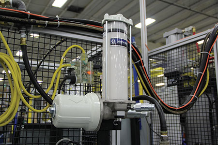

Automatic lubrication equipment typically includes a central pump that replenishes lubricants in small, metered amounts. Lubricant then flows from the pump through divider valves or injectors for dispensing at the lubrication point/machine bearing. Divider valves and injectors each have their advantages. Divider valves tend to be used in applications where feedback and monitoring are highly important, while injectors are ideal for tighter spaces and adjustability.
Automatic lube controllers allow users to program lubrication cycles to meet the specific needs of their machines or equipment. Maintenance technicians can also use the controller to monitor the performance of the system as well as inspect and troubleshoot issues.
When deploying automated lubrication equipment in a process environment, a good practice is to locate the pump and controller interface in an accessible area, outside any hazardous zones. This enables employees to refill the pump and adjust control settings without being exposed to safety risks or needing to follow potentially time-consuming safety procedures.
IMAGE 2: The automatic lubrication pump supplies pressurized grease or oil to the metering device, providing fluid power to the system.
