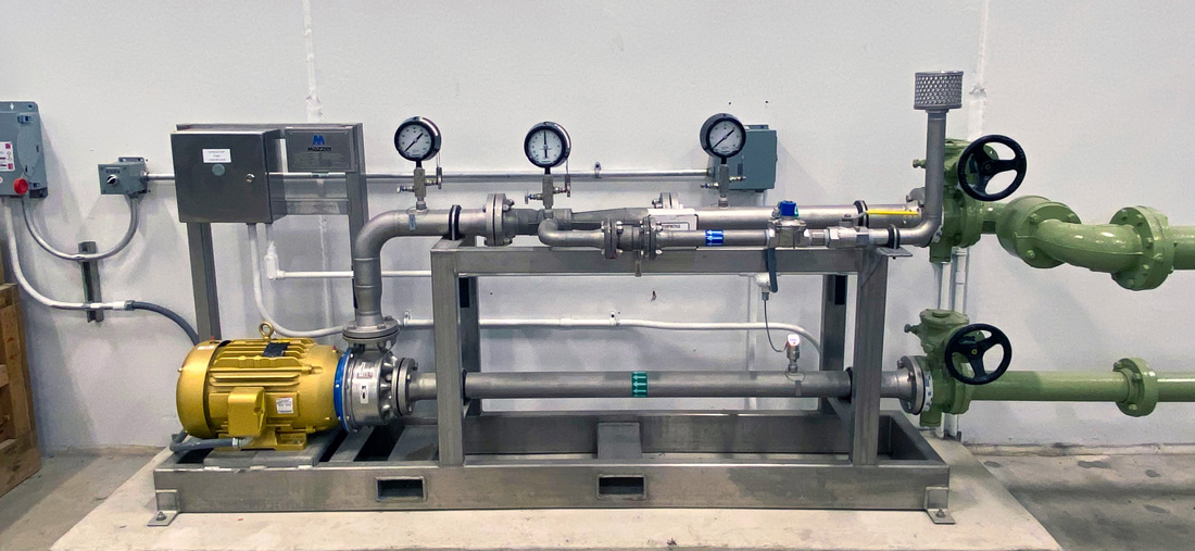

IMAGE 1: This skid-mounted sidestream aeration system boosts dissolved oxygen efficiently and occupies a small footprint. (Images courtesy of Mazzei Injector)

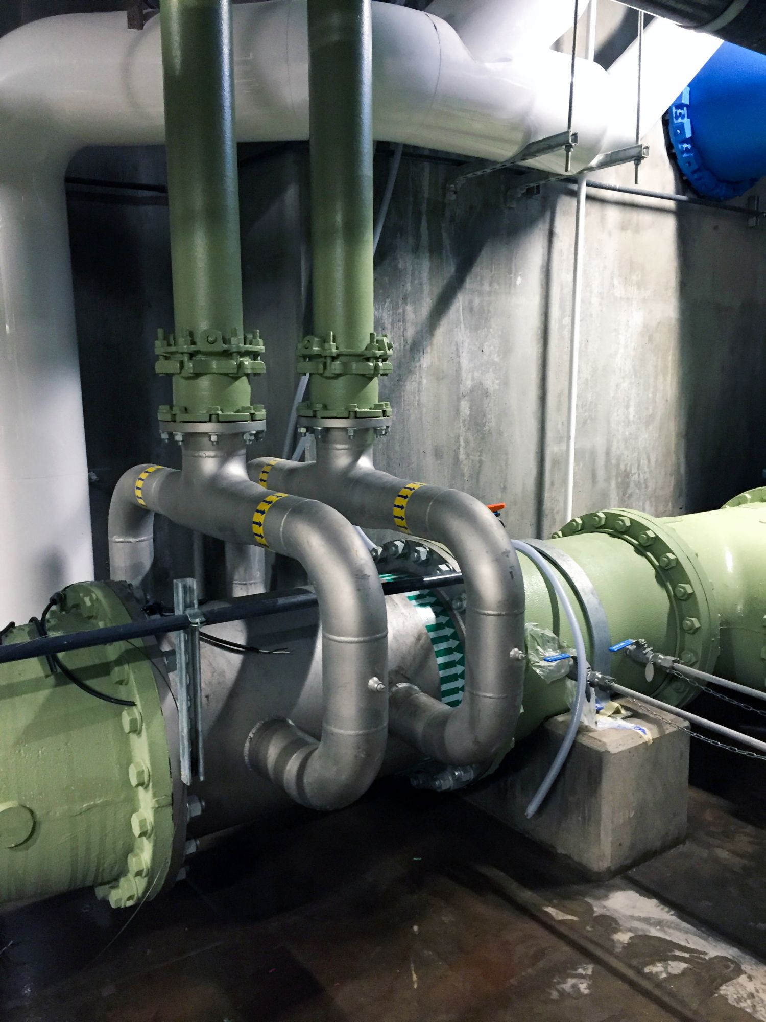

IMAGE 1: This pipeline flash reactor (PFR) thoroughly mixes an aerated sidestream back into the 24-inch main in Yankton, South Dakota, in just a few short feet of pipeline. (Images courtesy of Mazzei)

Sidestream injection, using venturi technology, along with a pipeline flash reactor (PFR) or pipeline nozzle manifold (PNM), can be a cost-effective way to reduce footprint and maintenance and achieve higher dissolved oxygen (DO) levels.
A typical sidestream injection system consists of one or two air injection skids and a PFR or PNM. A skid-mounted booster pump draws a sidestream from the mainline and pumps it through the skid-mounted venturi injector, which uses the flow of the water to create a vacuum that draws atmospheric air into the sidestream. The water/gas mixture is then blended back into the mainline through a stainless steel PFR or PNM that employs high velocity mixing nozzles to aggressively mix and uniformly transfer the oxygen into solution on the mainline. The PFR/PNM does not contain any static mixing elements or any moving parts, so maintenance is not an issue, and there is almost no mainline pressure loss across the unit.
Scalability is another benefit of PFR/PNM systems, which are often designed with a spare sidestream connection to allow for the addition of a future air injection skid.
If contaminant concentrations increase or water flow rates grow to exceed design peaks, the air injection skids can simply be converted to oxygen injection skids by adding an oxygen source, such as liquid oxygen (LOX) or an on-site oxygen concentrator, to achieve higher DO levels.

The design engineer was familiar with in-line gas contacting systems used for ozone applications and was happy to hear that the same equipment could be effectively used for aeration systems. In the end, the aeration equipment consisting of two air injection skids and a 24-inch PFR was conveniently installed out of sight in the building’s basement.
The system was started up in 2020 and is able to sufficiently aerate the raw water to oxidize up to 2 mg/l of iron that is subsequently removed by the multimedia filters.
