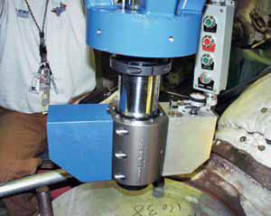

The steam bypass valve repair work was located inside the valve that has a 15.5-inch diameter pressure seal bore with the basket area in question located approximately 16.5 inches from the bonnet surface.
To repair it, plant engineers first preheated the A105 base material to 200 degrees and then conducted a weld buildup with a filler material in the throat of the valve at the seat. This left a small space that could be registered to.
Machinists were then brought in to machine the valve seat. To do the work, a portable boring machine was assembled and mounted to the valve body using the bearing housing and existing four valve studs, and it was registered into the valve body.
They then machined the weld to the proper bore diameter specification set by the valve manufacturer and the Palo Verde engineering department. See Figure 1.
Once the valve was bored, they worked to reface the taper at the bottom of the valve using a form tool. A measuring tool was used to get a clear reference for the depth of the valve.

Figure 1. A boring machine repairing the threads on a nuclear, high-pressure steam bypass valve.
A tool carrier was also set up to bore the diameter of the valve body. The same boring machine was used because it was able to take an additional tool carrier which was used as a reference for the machining depth.
By putting this second tool carrier on the machine, the micro-switch plate could then be used to gauge the stop limits and measure travel. The light and buzzer plate, which was developed by the plant's machinist, was mounted on the second carrier. It illuminated the interior of the valve and sounded when the tool reached its machining limit.

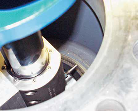

Next, the feed water control valve needed threads machined into the body of the valve. (See Figure 2) This work was located approximately 24.0 inches inside the valve from the bonnet surface. The thread pitch diameter was 16.9459 and 12 threads per inch. After putting a 45 degree seat in the valve's body, the machinists cut a 1/8-inch-wide thread relief.
Machining threads into the body of the valve
Figure 2. Machining threads into the body of the valve
Once that was established, they put a threading attachment onto the boring machine's tool carrier and zeroed the tool on the bore of the valve body and made a cut.
Another tool carrier was positioned on top of the machine with a buzzer and battery that could be set with a micro-switch.
A tool carrier with a buzzer plate and battery to assist with blind boring
Figure 3. A tool carrier witha a buzzer plate and battery to assist with blind boring
This let them know when they were in the relief. Since they were blind boring, they had to stop within one revolution of the thread relief or risk damaging the valve seat, and the micro-switch made it possible to stop in that thread relief. The boring machine had a dial indicator and thread gauge built in that enabled the machinist to tell how far he was advancing the tool. After the bore was machined to size for the threads, they set the threading attachment and achieved 17/12 threads per inch. Once the machine work and thread check was completed, the seat ring was torqued to 12,000 ft. lbs.

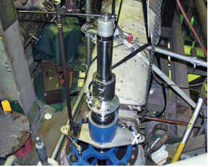

Circulating pumps' traditional packing is converted to mechanical seals to prevent wear on pump shafts and to ensure better leakage control. During one such conversion, the pump casings were severely corroded around the stuffing box faces, which would be used as a gasket surface for the mechanical seal. The stuffing box face had to be realigned and machined to provide a flat, true surface for the gasket before the new mechanical seals could be installed.
The size of the pump — more than 11 feet deep — posed another challenge. For this project, a portable boring machine was used with a 12-foot boring bar and a heavy-duty facing attachment. The portable boring machine is capable of line and blind boring even in cramped places in which other tools won't fit, and its inside-diameter bearing mount brackets have a wide mounting range. Its heavy-duty facing head attachment has a high metals removal rate to handle large-diameter facing jobs and can achieve a flatness of 0.003 inches. See Figure 4.
Circulating pump seal replacement
Figure 4. Circulating pump seal replacement
To position the 12-foot bar from one end of the pump to the other, a machinist got inside the pump to set up the inside diameter (ID) bearings. With the top half of the pump casing off, the bar was set in the bore with ID bearings. After the top was put back on, mounts were made to put the adjustable bearing on the outboard ends of the pump, allowing the bar to be adjusted, and the drive and feed hooked up. The bar was set up and aligned with a dial indicator so that it was perpendicular to the shaft and parallel with the installed bearings.
The surface was then cut with a facing attachment. This set-up avoided misalignment of the mechanical seal. Typically, converting pumps to mechanical seals can take up to 80 hours, but because machinists were able to conduct the repair on site, the project was completed within 25 hours, saving a substantial amount of time and labor.
