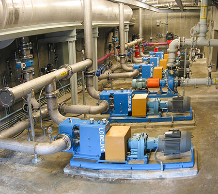

Rotary Lobe Pumps
The lobe-style pump was developed in the 1860s and was originally a design for an air compressor. The technology is quite simple: This positive displacement pump utilizes synchronized lobes on parallel shafts (Image 2). The lobes intermesh and rotate without contacting each other inside a casing and trap the fluid, displacing it through the pump from inlet to discharge.
Rotary lobe pumps can handle a wide range of media, including sludge, slurries and noncompressible solids. These pumps are widely used in the food and beverage markets, pharmaceuticals, some chemical plants and, of course, the wastewater industry—primarily for moving biosolids.

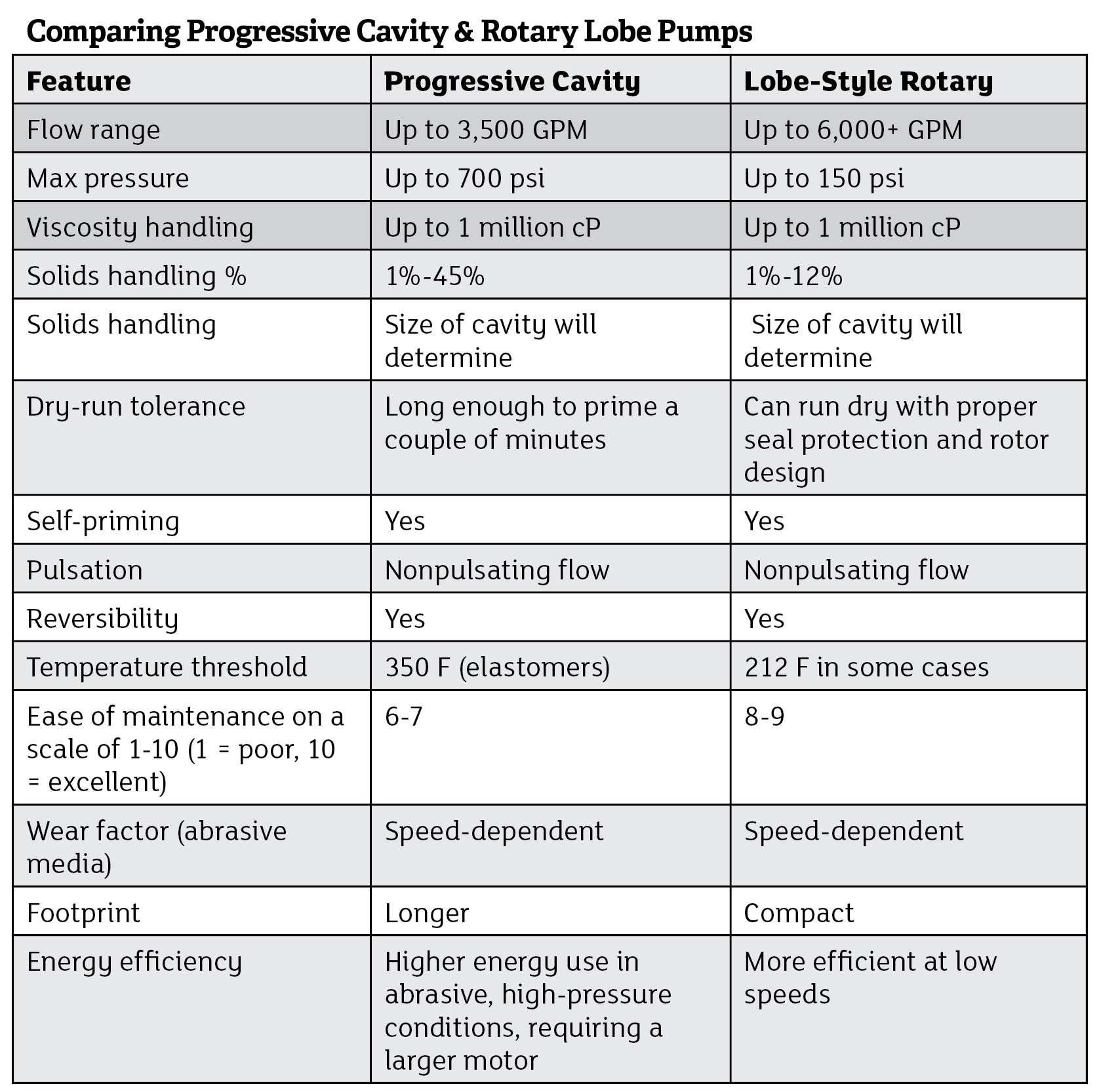

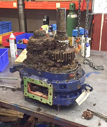

Rotary lobe pumps with the longest time between failures and lowest maintenance costs feature an air gap between the rotor housing and gear case (Image 3). This isolates the drive components in the event of a wet-end seal failure.

Both pumps are equipped to perform in cake and sludge transfer applications, but neither is perfect. An evaluation of process and other internal factors will help lead to a decision. Things to consider:
- Available space
- Flow and pressure requirements
- Dry-running potential
- Maintenance experience with either technology
If the application requires the following, the PC pump may be the best bet:
- High pressure
- Ultra-high viscosity
- High percentage of solids
- High temperature
However, if a user’s priorities include any of the below factors, the lobe-style pump, especially with advances in straight-lobe technology, will likely be the better option:
- Compact design
- Ease of maintenance
- Dry-run capability
- Handling oversized noncompressible solids
