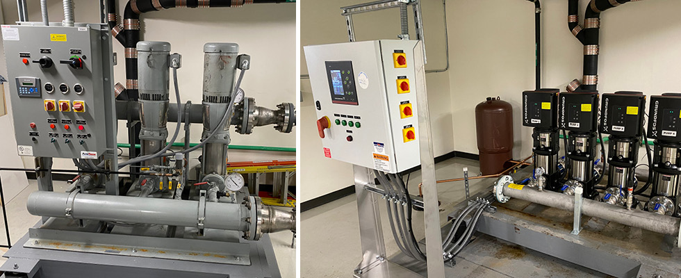

IMAGES 1 & 2: Before (left) – booster skid with three 20-hp constant-speed pumps operating in sequence; after (right) – high-efficiency booster skid with four 5-hp smart pumps using variable-speed control for improved efficiency and redundancy (Images courtesy of Resource Innovations)

Case Study: Right-Sizing for Results in a 20-Story Office
A 20-story office building in Bellevue, Washington, struggled with chronic noise, vibration and maintenance issues from three 20-horsepower (hp) distribution pumps operating in simple on/off control. The retrofit replaced this oversized trio with four 5-hp electronically commutated motor (ECM) smart pumps, each with built-in variable-speed control.
Beyond the control upgrade, the key improvement was right-sizing. Distributing capacity across multiple smaller pumps increased turndown capability, improved redundancy and kept operation closer to the pumps’ best efficiency point throughout the year. The result was an 87% reduction in pump energy use, along with quieter operation and lower maintenance demands.
