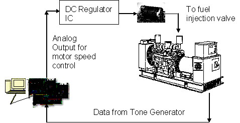

Speed Control of Diesel Generator Sets
The DG sets are powered by a mixture of diesel and producer gas created in an 80-kilowatt gasifier. The engine speed increases as more gas is input, so the diesel fuel intake must be reduced to achieve constant engine speed and line frequency. The engine speed is detected by using the software to find the frequency of the tone generator output attached to the engine shaft. The closed-loop control system generates signals through the multifunction software system’s data acquisition (DAQ) device to control diesel flow in the engine. The output from the DAQ device is applied to a small DC motor through a DC regulator IC that screws or unscrews the generator’s fuel control screw.
Figure 1. Closed-loop speed control of DG set

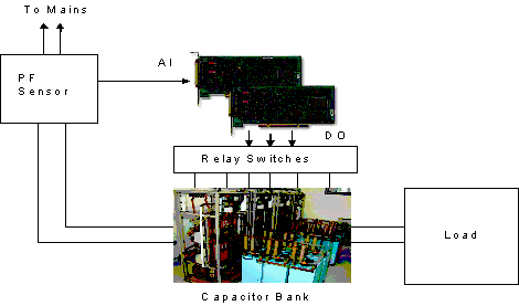

Power Factor Control
The system performs power factor sensing through the analog signal from a power factor transducer. The signal is fed from the multifunction I/O DAQ device to the control system built into the software. The control system has a set of digital outputs that switches 24 relay switches on and off. The relay switches control contactors that add or remove 15 capacitors in a capacitor bank. The power factor remains near the desired 0.92 set point.
Figure 2. Closed-loop power factor control

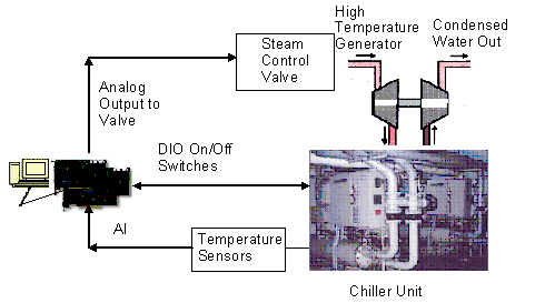

Automatic Control of Chiller Machine
Previously, the system used a programmable logic controller (PLC) for the chiller machine, but spare parts were costly and problems occurred with the PLC main card. The decision was to replace it with a software system. Operators monitored the temperature at five points in the machine. The chiller machine is energized by steam and controlled by first generating a ramp output during a 12-minute span from the DAQ device attached to a system that supplies steam to the high-temperature generator of the chiller machine. Using the software, operators implemented automatic switch control to open and close the steam valve from 100 percent to 0 percent. Water is cooled to 4 C, and the steam control valve is modulated depending on the current temperature.

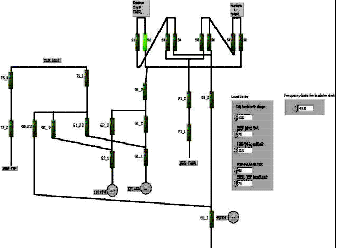

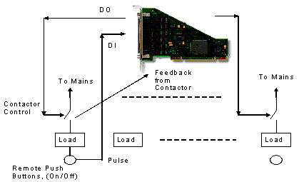

Electric Load Management
The total connected load is 75 kVA and 85 kVA in two units. The plant operators must manage the load to avoid going beyond the maximum limit or exposing the system to instability. The same load management system that was used to remove the possibility of sudden loading on the DG sets (125 kVA, 110 kVA, 40 kVA, or 20 kVA depending on load needs) when attempting to start several loading units at the same time was used in this process. The plant runs 80 subunits through this power supply. The operators introduced a scheme in which each piece of equipment released a pulse for a duration of its startup. This varied depending on the type of equipment—fans, centrifuges, pumps or motors. Sequence starting was implemented on a first come, first serve basis using digital I/O cards. The software system was used to log the starting and stopping of different units.
Figure 3. Electric load management
Figure 4. Sample VI
Figure 5. Sample VI
