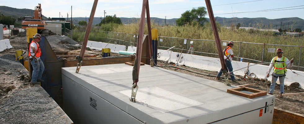

IMAGE 2: Placing one of three interconnected rectangular wet wells

Image 1 shows that instead of one continuous, wet-poured, 8-feet wide by 54-feet long by 20-feet deep vessel, the pumping system manufacturer precast three vessels, each being 8 feet wide by 18 feet long by 20 feet deep with large interconnecting piping. They also created a three-vessel sump that was structurally three separate vaults forming a single pumping system sump that would replace and long outlast the old sheet pile sump.
Stormwater pumping systems must often be designed to handle a wide range of influent volume, and this system was no exception. The first chamber of the sump—8 feet wide by 18 feet long by 20 feet deep—was designed to handle low and/or normal volume. Its selection included two pumps that combined to handle approximately 12,000 gpm.
The second chamber does not come into play until the volume of water inflow exceeds 12,000 gpm. This second vessel is designed to handle two more pumps, bringing the overall pumping rate to approximately 24,000 gpm. It is important to recognize that progressive pumping scenarios like this must be configured to grow with the inflow in their ability to
pump a larger volume of stormwater as the event increases.
The third chamber is the location where larger vertical turbine pumps in the system will be used when the pumps in vessels 1 and 2 are unable to keep up with the inflow.
