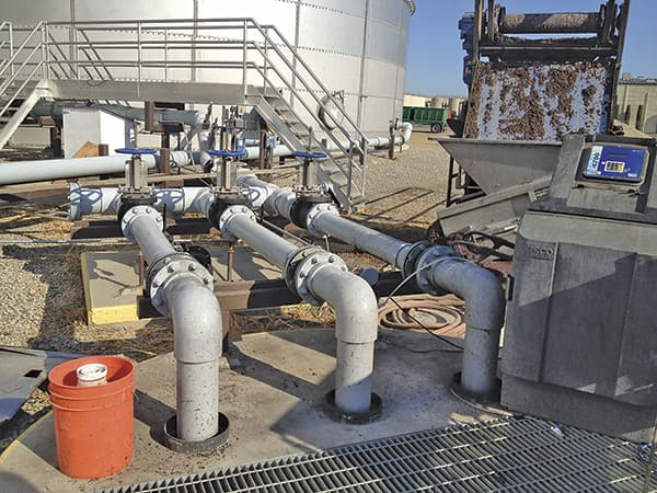

The triplex lift station arrangement provides a solution for grape wastewater processing.

The pump distributor’s team decided to specify three submersible pump models that were installed in a triplex arrangement. The triplex lift station is a unique arrangement of three pumps operating in parallel.
Specifying three pumps for the sump (instead of one or two larger pumps) increases the system’s reliability while efficiently covering the required wide range of operating conditions between the seasons. The triplex control allows for the operation of one, two or all three pumps at a time depending on the changing rate of inflow to the tank. The pumps alternate lead and lag position. In this arrangement, they are exercised regularly and wear more evenly. A high-level alarm is also available.

The final system was installed in 2008. As designed, all wastewater flows to the wet well containing three submersible pumps in parallel—including a lag pump, a lead pump and a spare. They remain totally submerged for maximum cooling, even at the lowest liquid level. Effluent flows from the wet well to the equalization tank and the reactor and into aerobic settling ponds. The wastewater is held in these ponds until required for irrigation. Based on content, the ponds are drained and dredged to remove any sludge buildup.
Simpson has been happy with the system’s reliability. “The pumps have been installed for five years, and during that period, the only main­tenance that was required was a single seal replacement.
“Fortunately the warning system advised of the seal failure, and we were able to easily switch to the backup pump while we replaced the seal. There was no slow down or stoppage in production.”
