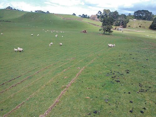

%20(1).jpg)
Subsurface drip irrigation in the sheep paddock. Photo courtesy of Innoflow Technologies

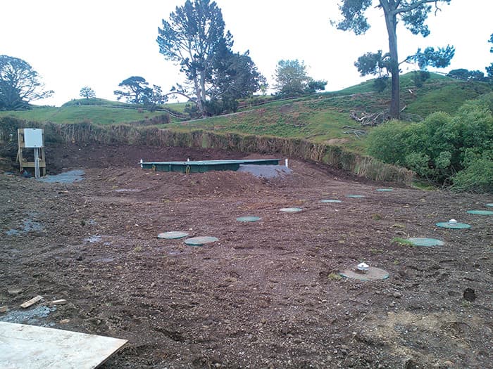

The Treatment System
The system consists of two specialized filter pods, but it was designed with expansion in mind. A proposed visitor center to accommodate bus tours and a plan for a wedding facility could expand the system to three filter pods.
The treatment system uses an engineered textile media to treat wastewater that is capable of meeting stringent regulatory requirements. Influent is intermittently recirculated over the textile media, which houses the cleansing aerobic bacteria, similar to the operation of a recirculating sand filter. A buffer tank precedes the recirculation tank, so the system provides consistent, reliable treatment, even under peak flow conditions.
%20(1).jpg)
The wastewater treatment system. Photo courtesy of Innoflow Technologies
Alternating duplex pumps (50 gallons per minute, 1 horsepower, 220 volts, 50 hertz, single phase) recirculate the effluent through the filters at an approximate 3:1 recirculation to discharge ratio. The pumps use a super stainless, 4-inch submersible motor. The treatment system company has been using the same submersible motors for more than 25 years. They have a corrosion-resistant, stainless steel shell, with stainless steel internal components and nitrile rubber seals.
The internal features of this motor include hermetically-sealed windings, a Kingsburg-type thrust bearing, pressure equalizing diaphragm and built-in lightning arrestors. The 2-wire starting switch aids and prevents extremely fast cycling.
The effluent pumps were inspired by the required longevity of well pumps and were designed to transport screened effluent with low suspended solids. The pumps are capable of 24-hour run-dry with no deterioration in pump life or performance. A patented 1/8-inch (3-millimeter) bypass orifice ensures flow recirculation for motor cooling and to prevent air bind.
The pump’s liquid end is specifically designed for wastewater applications. Diffusers and discs are made of an abrasion-resistant polyphenylene oxide/polystyrene blend. The pump is field repairable.

Following the filter pods, treated effluent is discharged by alternating pumps (30 gallons per minute, ½ horsepower, 220 volts, 50 hertz, single stage) with a floating impeller design. Effluent flows through a water meter and to a pressurized drip system. The clear, odorless effluent is ideal for reuse applications. For example, at Hobbiton, the effluent is used to help irrigate one of the sheep pastures.
