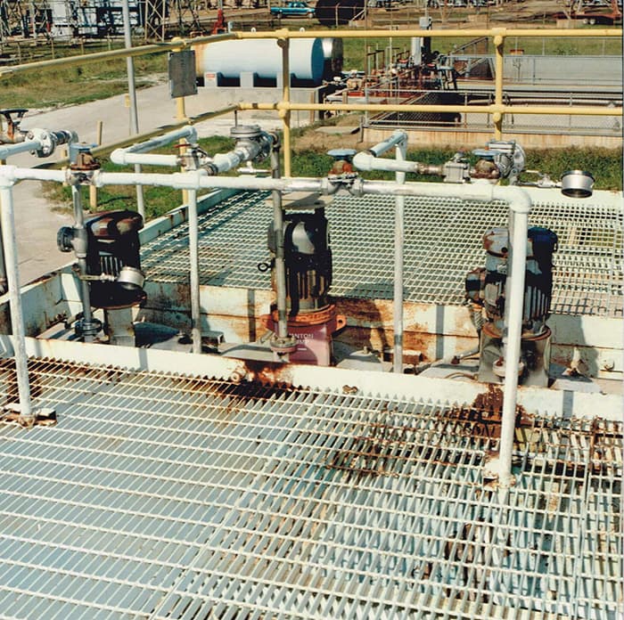

Pump performance is critical to this operation. Handling various concentrations of sulfuric acid and sodium hydroxide creates contamination and corrosion problems, which result in high pump maintenance costs and excessive downtime. As part of the corporate cost-saving initiative, the maintenance group reviewed alternate chemical pump designs. The review prompted the maintenance superintendent to test a vertical centrifugal thermoplastic pump on the caustic system.
The selected pump needed to deliver 20 gallons per minute (gpm) of 50 percent caustic at 108 F against a 46-foot total dynamic head. To handle the task, the pump's casing, flanges, impeller, vertical column and cover plate were made of homogenous virgin polypropylene. The pump's 96-inch vertical shaft was isolated from the solution by a thick polypropylene sleeve, and a special shaft seal protected the bearing and motor from corrosive fumes.
Results of the test were positive, and a similar pump was installed on the acid tank. To handle the sulfuric acid, the material specified for the wetted end and the shaft seal was polyvinylidene fluoride (PVDF). The pump was required to deliver 20 gpm of acid at ambient temperatures against a 55-foot total dynamic head.
The sulfuric acid and sodium hydroxide required for the ion exchange purification process is stored in these large tanks outside the processing building. A concrete containment vault served to catch any spillage.
Because of the performance and service records of the two initial pumps, the plant\'92s maintenance manager decided to replace all six metal pumps with thermoplastic pumps manufactured to the same design specs as the test units.
