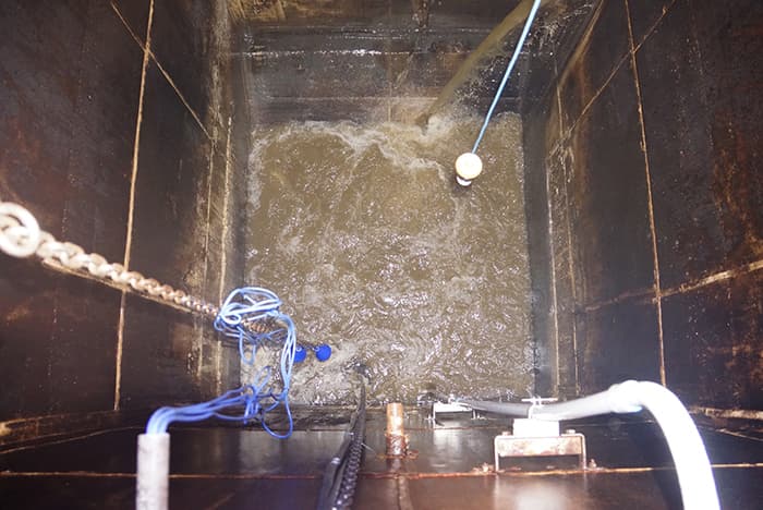

San Diego Relies on Conditioning Pump to Eliminate 4-foot Floating Mat in Pump Station
The City of San Diego’s Otay River Pump Station pumps 7 to 9 million gallons per day (mgd) of raw sewage to the South Bay water resource facility (WRF) for water recovery. To address plugging of the station’s previously installed submersible pumps, the city upgraded in 2007 to 200-hp submersible pumps in wet well No. 1, and in 2010 with 40-hp submersible chopper pumps in wet well No. 2. With the pump plugging problem eliminated, city maintenance workers decided to find a solution for the buildup of floating grease and debris, sometimes as thick as 4 feet, that would collect in the large wet well No. 1 (50 feet long by 10 feet wide by 30 feet deep). The city had been hiring two vacuum trucks and adding six crew members at night on overtime to clean out the station every three to four months at a cost of about $120,000 per year. To eliminate this expensive problem, the city called on a pump manufacturer whose chopper pumps have been used in lift stations as “conditioning pumps” to chop and fluidize grease and debris, to create a more homogenous fluid that can more easily be mixed and removed from the wet well..jpg)
