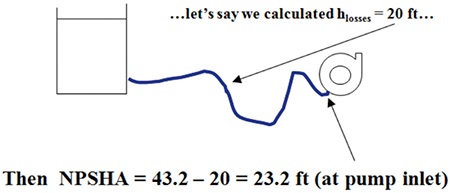

Figure 3. Sample pump operation (from the August 2013 issue)
If: hf = f x (L/D) x V2/2g = 20 = 0.03 x (L/12) x 14.22/2g Then: L= 2,552 inches = 211 feet With several estimates, there is now a starting point.
In Figure 3, assume that no kinks or turns are present in the piping. Then modify your answer by estimating and adding the pipe losses shown.
Again, we will use a practical approach to the kinks. The 90-degree pipe bend results in a loss of one velocity head. For non 90-degree bends, the loss would be less or possibly more, but we will use the 90-degree bend as a good starting point. Approximately five bends are shown in Figure 3, and each one takes the following:
hbend 3-inch = V2/2g =13.62 /2g = 3 feet
hbend 12-inch = V2/2g = 14.22 /2g = 3 feet
For five bends, 15 feet of losses are added. That would leave only 5 feet (20 – 5) for friction losses (initially assumed as 20 feet), and it would require recalculation, with the resulting pipe length much shorter to produce the same overall friction loss. As shown in this example, it is not the length—but the kinks—that kill pumps in cavitation. In conclusion, keep your pipes straight. Email your comments or join the debate at my next pump school: www.pumpingmachinery.com/pump_school/pump_school.htm.
