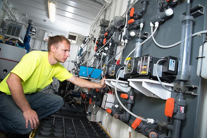

The portable water treatment process trailer was built on a 40-foot flatbed trailer and includes a 20-foot metal shipping container housing the instrumentation and process controls. The container also includes the pumps, valves, ozone generator, air compressor and air dryer used in the process. Sample ports, testing equipment and a control enclosure are also housed in the container. This complete water-treatment process training and research platform includes chemical dosing, main fluid flow, and air and ozone fluid flow systems. The external process control system includes a pair of interlaced lime green plug-flow reactors that perform the treatment, and a pair of blue catalytic filter towers (see Image 1). Each 45-foot plug-flow reactor is followed by a catalytic filter tower—a self-cleaning moving bed reactive sand filter. Small doses of functionalized biochar and ozone are metered into the first reactor, with sand in the first filter made highly reactive to remove trace contaminants. Precise amounts of ozone and metal salts are pumped into the second reactor effluent for high efficiency water polishing. At the output, the byproducts, phosphorus and nitrogen bound to biochar, are recovered for use as fertilizer. The effluent then moves through the second sand filter where the water is polished again. The output of this filter is clear, clean water..jpg)
