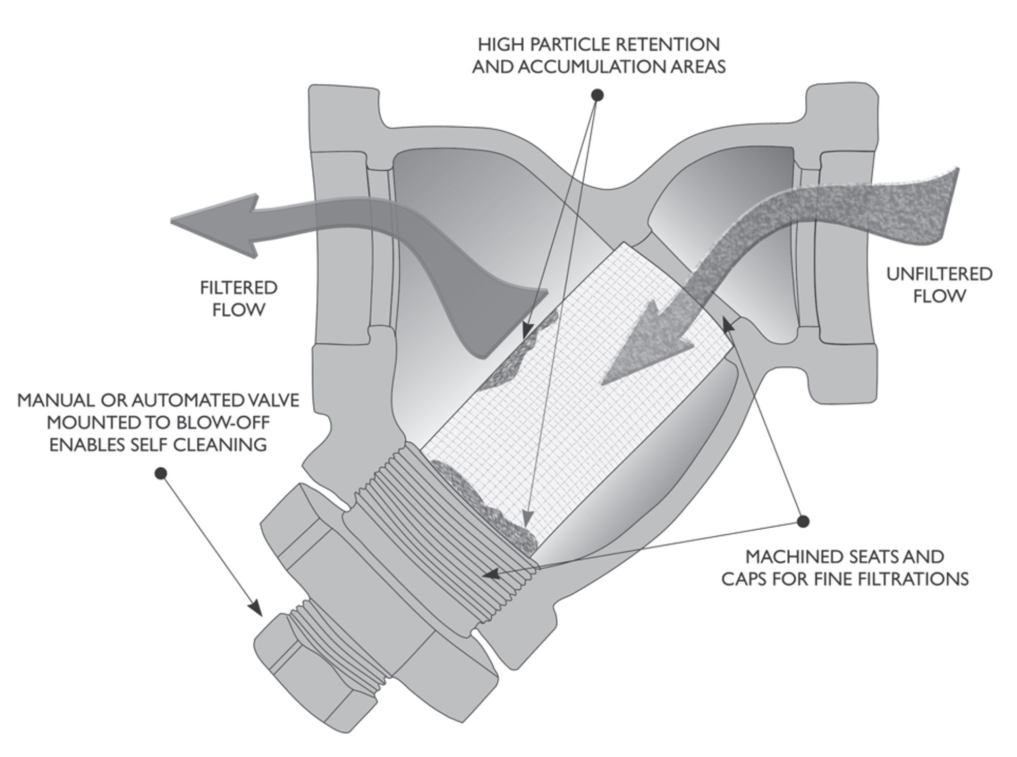

An official definition of “strainer” adopted by the Fluid Control Institute is “a closed vessel with a cleanable screen element designed to remove and retain foreign particles down to 0.001-inch diameter from various flowing fluids.”

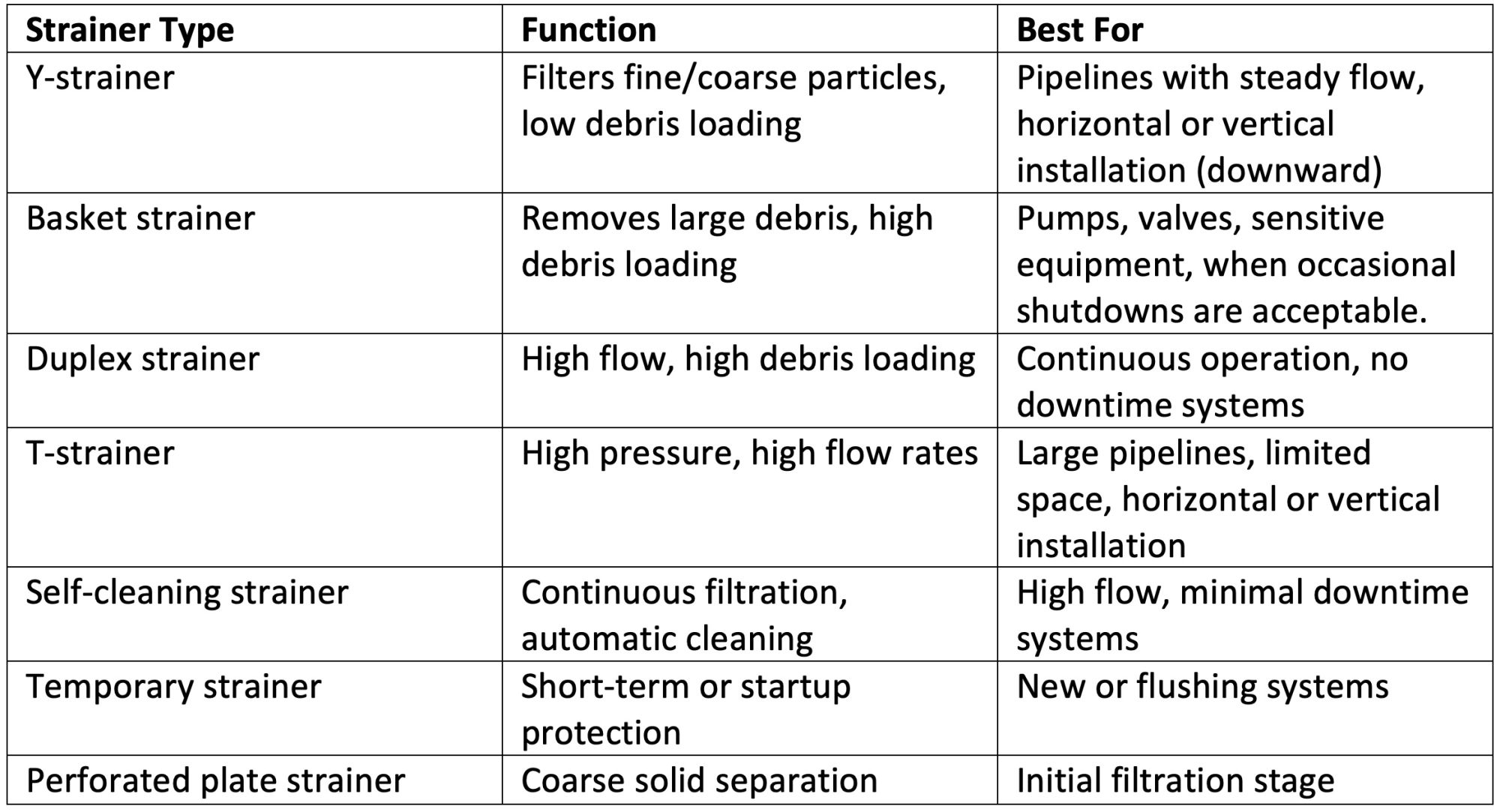

Strainers are devices used in piping systems to filter out unwanted debris and solid particles from a liquid, gas or steam flow. They usually have a perforated or wire mesh element that traps these particles, allowing the cleaned fluid to pass through. Various types of strainers are used throughout a system at different stages, depending on the application. These include temporary or cone strainers, perforated plate strainers, Y-strainers, basket strainers, duplex strainers, T-strainers and automatic or self-cleaning strainers. The choice of mesh size, strainer material and design depends on the process requirements, the type of solids, the flow rate and the cleaning methods. Selecting the correct type of strainer is essential for maintaining the system’s longevity and optimal performance.

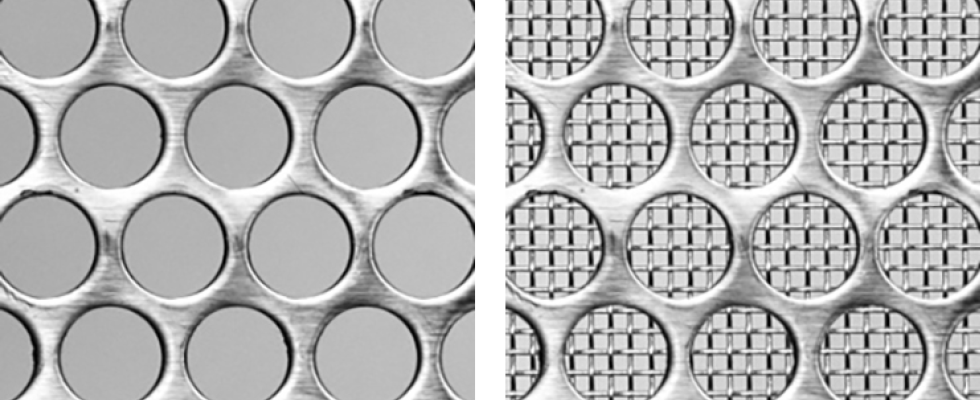

- Improper mesh size or basket type: In high-solids environments, choosing a fine-mesh element can lead to rapid clogging, whereas selecting an element with larger perforated openings can allow debris to pass through. For example, a 325 mesh in a system with heavy sludge may clog daily, while a screen with larger openings might offer better performance. In general, screen openings should be approximately one-half the diameter of the largest allowable particle. The largest permissible particle is defined as the size of a particle that can pass through downstream equipment without causing damage.

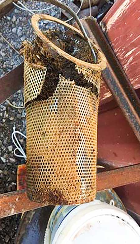

- Inspect the strainer basket or screen: Isolate the strainer and remove the basket or screen. Visually inspect for debris type, corrosion or deformation. This can offer clues about the nature of the clog—whether it is organic, fibrous, mineral or a combination of these. Soft, gummy materials like tars and resins are more difficult to remove and clog baskets more quickly than hard crystalline materials.
- Analyze the debris: Collect a sample of the material causing the clog. If fibers dominate, the source might be packaging or textiles. Heavy sludge may indicate the accumulation of process waste. Use this to refine mesh size or recommend upstream screening.

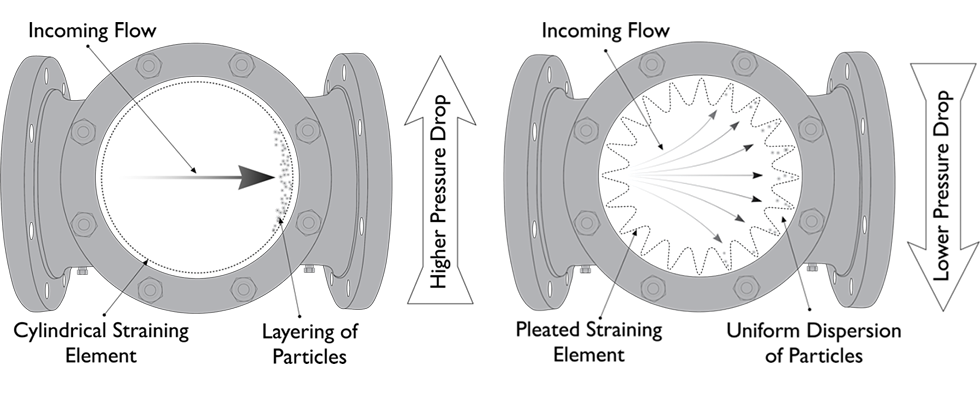

- Improving on mesh size and basket design: Reevaluate the balance between protection and flow. For sticky or fibrous materials, wedge wire baskets with appropriate open area and support ribs reduce clogging. The baskets can also withstand full line pressure when clogged. Particle retention is directly related to the amount of surface area available on the straining element. In cylindrical elements, the accumulation pattern can sometimes cause the outlet side of the strainer to clog quickly, resulting in an increase in pressure drop. Pleated straining elements can expand the straining surface area and uniformly disperse the particles. This alleviates buildup and typical pressure loss.
