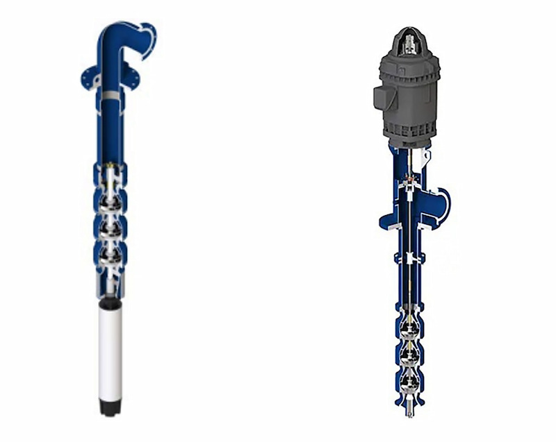

What Is a Vertical Turbine Pump?
IMAGES 1 & 2: Line shaft pump (left) and submersible pump (right) (Images courtesy of Xylem)
Vertical turbine pumps, also known as deep well or line shaft pumps, are submerged underwater and commonly used for high-head applications in agriculture, manufacturing and municipalities. Typical configuration includes a driver unit, head assembly, column assembly and bowl assembly. Customizable features like dual wear rings and different seals help tailor the pump for specific needs to ensure efficient, reliable operation. Pump vibration can occur throughout different components of the pump, which may need to be modified to achieve peak performance and eliminate excessive vibration.
