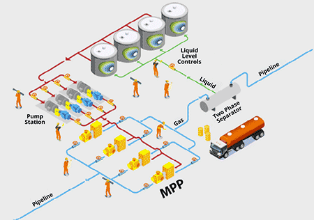

An example of a multiphase pipeline is shown in Image 2. The multiphase pump will do two things. First, by lowering back pressure in the gathering lines, the production is increased. Second, by boosting the commingled flow in a single multiphase pipeline, phase separation and processing can be removed from the producing field.

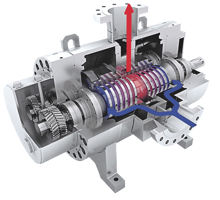

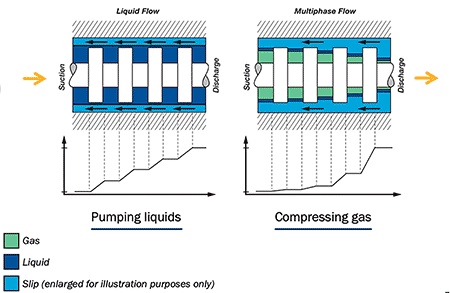

A twin-screw multiphase pump can pressurize liquids and gas in any combination without separation or phase split, as shown in Image 4. The liquid that is needed for sealing the screws and to remove the heat of gas compression comes from the process and is circulated back to the pump from a downstream liquid knock-out boot. The gas is compressed by the internal liquid slipstream traveling in the clearances between rotors and liner, allowing the pump to go from 100% gas to 100% liquids in an instant. Low internal velocities and the absence of pulsations result in low stress to shear-sensitive liquids.

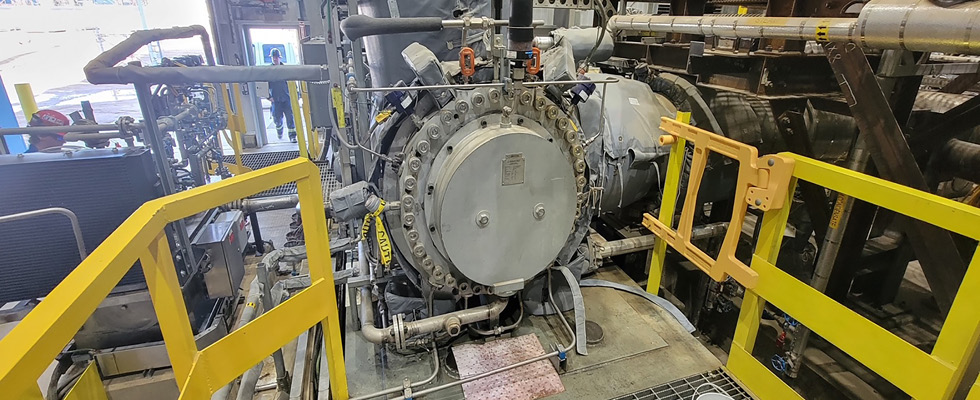

Image 5 shows an example of a 2,800 horsepower (hp) twin-screw pump serving a Canadian 24-inch, 60 miles long heated and diluent injected heavy oil trunk line. Another advantage is its ability to start up a shut-in line using variable speed control to slowly build up flow while maintaining full discharge pressure.

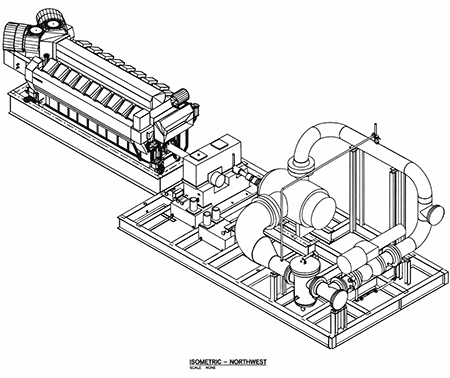

In remote areas, natural gas or diesel fueled engines for driving the multiphase pump can be used. Image 7 shows an illustration of how a larger diesel engine-driven pump skid could be featured.
