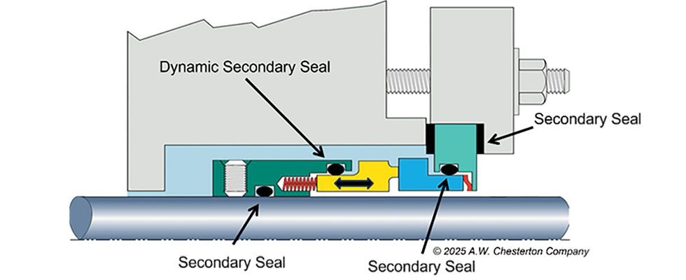

Secondary sealing elements provide all static sealing within the mechanical seal, as well as the dynamic axial motion of the seal faces (Image 1).
Secondary sealing elements are found in any interface where two components are mated and a leak path exists. Examples include the interface between the mechanical seal’s sleeve and the shaft of the sealed equipment; the mechanical seal gland and the mounting flange for the mechanical seal; the interface between the stationary seal face and the gland; and the interface between the rotary seal ring and the holder or sleeve where the seal rings track axially during operation (Image 1). There are several different types of secondary sealing elements, and they come in a variety of materials with various characteristics and capabilities that must be considered.

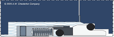

- O-rings are secondary sealing elements with a circular cross-section. O-rings offer simplicity in installation and versatility in a wide range of sealing applications, and this is why they are the most common type of secondary seal used in mechanical seals. Based on the elastomer chemistry used, O-rings can offer a cost-effective sealing alternative. O-rings can be made from several different elastomeric compounds that can range from a very low cost to extremely expensive depending on their performance capabilities (temperature and chemical compatibility). O-rings also come in different durometers (hardnesses), which gives the designer the ability to tailor the seal design to a specific application (e.g., high pressure or temperature), which can benefit from higher durometer O-rings. Image 2 illustrates a basic mechanical seal with O-ring secondary seals.

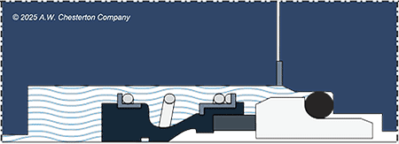

- Elastomer or thermoplastic bellows are found in a variety of seals where sliding dynamic secondary seals are not optimal. These elastomeric bellows are designed not to slide relative to other components in the mechanical seal, but they deflect to allow motion of the seal faces. Like O-rings, these bellows come in a variety of material choices based on the specific application and seal design requirements. These bellows may be called “boots” because they encapsulate the dynamic seal face like a boot. Image 3 illustrates a basic elastomeric bellows seal design.

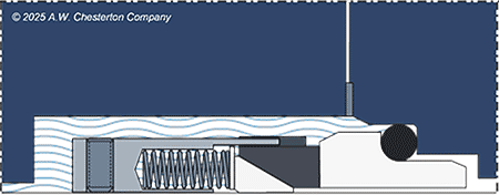

- Wedges (polytetrafluoroethylene [PTFE] or carbon/graphite), like O-rings, get their name from their cross-sectional shape. This type of secondary sealing element is used in a mechanical seal where an O-ring or other type of secondary sealing element is not a suitable choice due to temperature or chemical exposure concerns. While wedges require external energization to seal effectively, they can offer a cost-effective solution to higher cost performance elastomers. However, wedge seal designs do have some limitations the seal designer or user should be aware of. These limitations include potential for “hang-up” in dirty services with solids and contaminates, fretting of the pump shaft/sleeve due to the axial motion of the wedges against the mating surface and limited axial motion capabilities. Image 4 illustrates a basic wedge seal design.

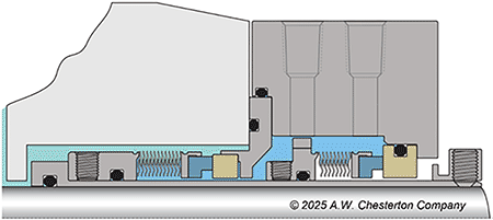

- Metal bellows are used in place of elastomeric elements and are common in high-temperature, vacuum or hygienic applications. Metal bellows are either formed from a single piece of metal or welded from multiple thin metal plates. Metal bellows serve a dual purpose, providing secondary sealing as well as the spring load that allows for axial movement of the seal rings. Image 5 shows a welded bellows seal design.

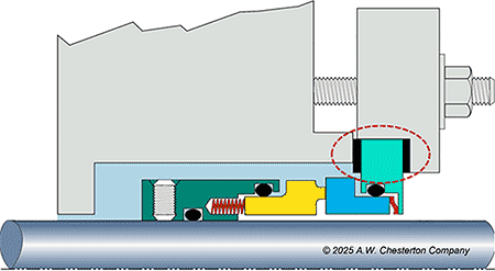

- Flat gaskets of various material types are frequently used to seal the mechanical seal’s gland to the mounting flange on the piece of equipment to be sealed. Flat gaskets may also be used on other static applications within the mechanical seal assembly. As flat gaskets have no ability to move, they are only used in static interfaces where they can be compressed to provide sealing. As these are compression types of seals, they should only be used once and replaced when the mechanical seal is refurbished for further use. Image 6 shows the use of a gasket in a mechanical seal.
