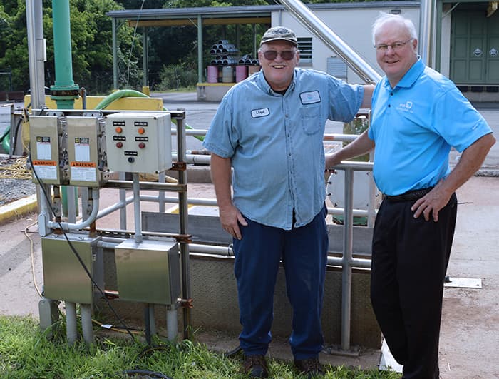

Image 1. About 30 septic dump trucks bring waste into the VFSA pumping station every day. (Images courtesy of KSB)

Part of the plant includes a dedicated septage receiving wet well. The septage waste is then pumped to an equalization tank, prior to being flow-paced into the treatment plant process. Knauer said that before the pumping system upgrade in 2002, the wells were overflowing regularly because the truck operators did not realize that the pumps were not transferring the materials that were causing the clogs. “We would either find out from the operators after an overflow occurred, or from the high-level sensors that we eventually had to install,” Knauer said. “Whenever the overflows would happen, two mechanics would have to come over and get down inside the dry well, shut off all the valves, pull the pump apart, pull the impeller out, unclog it, and put it back together. In the septic business, downtime means lost money. During emergency shutdown of the pumps, the dumping process was curtailed until the pumps could be returned to service, with the result that septage trucks would be waiting as long as several hours until the pumps were back in service.”
