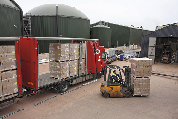

Packaged food waste arrives at Cannington.Accelerated Batch Times

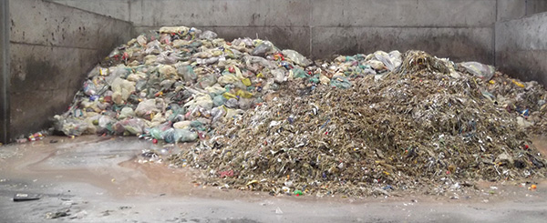

Annually, 60,000 tonnes of food waste is first shredded on its way to becoming a renewable energy source. Bagged food waste (left) that will soon resemble the already macerated material on the right.

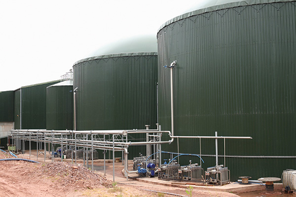

The number of digesters at Cannington is soon to double from three to six.
