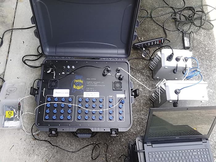

"I enjoyed your four-part series (Pumps & Systems, July, August, September and October 2015, read them here) relating the dynamics of what goes on at the plants in an interesting real-world dialogue format. You started the set by introducing the reader to a pump salesman, Bob, who visits the water plant and works with a local plant maintenance manager, Jim, on measuring the efficiency of his large pumps. Other people get involved along the way, and the amount of savings they discovered shocked me—nearly $125,000 for a 3,000-horsepower pump. In Part 1 of your article series, you said the entire test was done in less than a day by a system you referred to as "PREMS," but you did not describe what it is. We have plant monitoring systems in our plant, but they cost millions, and I doubt that anything, no matter how simple that may sound, can be done in a day. Can you elaborate?" Jack Francis Chemical plant employee Chicago, IllinoisNelik's Response
Thank you for your question. It does not surprise me that the amount of wasted energy seemed so high to you. Most folks think more about a piece of machinery's reliability than about its efficiency. The thought process is, "If a pump fails too often, water spills all over the plant, and I get home late for dinner." That is personal. But to look at a running pump to see 10 percent efficiency being wasted, that is often too abstract. But the numbers are there—in dollars instead of red ink on a pump housing. Consider the 3,000-horsepower (hp) pump in the articles you mentioned. Multiplying 3,000 hp by 0.746 gives us 2,238 kilowatts. Multiply that by 24 hours for 365 days, times $0.10 per kilowatt-hour, and it adds up to $2 million. If 10 percent is wasted, that is $200,000. The $125,000 in the articles is adjusted for the pump running less than 100 percent of time. For details of how to measure efficiency, let me do a brief review. In March 2007, Pumps & Systems published "How Much Energy is Wasted When Wear Rings Are Worn to Double Their Initial Value?" Double was picked because that is the point where most original equipment manufacturers (OEMs) recommend replacement of rings. But such repairs are costly. Users do not know the worn dimensions until they pull the wear rings from the pump. By measuring efficiency continually, they can pinpoint the time when the efficiency value drops below the value that justifies the repair and restoration of the ring clearances to the initial OEM recommended values. Continuous monitoring reconstructs the entire performance curve, because most pumps do not "sit" at the same flow. In response to changes in the system, the flow changes, and pressure, power and efficiency change with it. A dynamic, live reconstruction of the performance curve does not require intrusive periodic testing. Continuous monitoring makes the performance curve more accurate and detailed over time. It would also tell where the plant typically runs—something that plants often do not know. In regard to the pump's reliability and efficiency measurement system (PREMS) in Part 1 (Pumps & Systems, July 2015), the key to a good technology is accuracy and simplicity. The PREMS is essentially a box, similar to a suitcase, that can be installed for one pump, monitoring it for a period of time, and then moved as needed to another pump..jpg)
