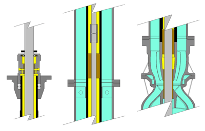

Figure 1. (l.) The resultant eccentricity between rotor and stator caused by loose fits between the bowls and columns. (center) The resultant eccentricity caused by a lack of parallelism between the mating faces. (r.) The resultant rotor eccentricities caused by loose fit by threaded couplings.
Vertical Pump Repair Concepts
The overriding repair concept for vertical pumps is two-fold: establish true centerline compatibility between the rotor and stator at the motor-to-discharge head flange location and ensure that the maximum relative radial displacement of the stator to the rotor-at any point for the pump's entire length of the pump-does not exceed the minimum clearance of the closest running fit.
The goal is to insert the rotating assembly into the stationary components with uniform radial clearance maintained through the pump from the lower bearing to the head stuffing box. This can only be achieved through the application of tight tolerancing standards.
