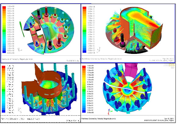

Figure 3. Snapshots of the CFD simulation (top, La Caldera PS; bottom, Caracol PS)

Figure 3 shows how the optimized design looks when elaborated through multiple simulation turns.
In both cases, the incoming flow will lose much of its energy in a pre-chamber, from which the flow is directed to the dry-weather pumps.
At a certain water level, the incoming flow brims over to the sump’s rain-weather section. Therefore, the heavier, polluted wastewater stream will remain in this part of the sump and not be distributed to the whole sump.
A protective wall guarantees that the approaching velocities remain within acceptable limits (with respect to absolute values, as well as distribution profiles close to the pump’s suction inlets) despite the fact that 20 m³/s mean a huge amount of kinetic energy.
The design was developed to maintain minimum velocities close to the sump bottom even during low-flow periods, which is vital to limiting sediment built-up in the sump. Dead zones could be completely eliminated.
Additional design features were necessary to prevent the pumps influencing themselves and prevent the formation of entrained air on the surface vortices.
