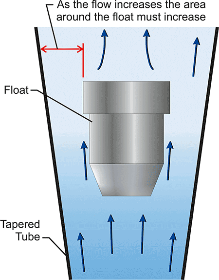

IMAGE 1: How a variable area flow meter works (Image courtesy of Blue-White)

Tapered Tube
The flow meter body is a vertically tapered tube. Fluid passes from the smaller end to the larger end of the taper. As fluid flows through the tube, it forces an indicator (float) upward. The clearance space (annular area between the float and the tube wall) between the float and the tube increases as the float moves toward the top of the meter. The larger clearance area toward the top requires a larger amount of fluid to force the float higher. The greater the flow, the higher the float is raised.
By varying the taper of the tube, as well as the mass of the float and the length of the tube, different flow ranges can be calibrated. A scale with flow increments or measurements is typically printed next to or on the tube. The flow rate can be read by matching the increments on the calibrated scale with the edge of the float.
Proper installation of a variable area flow meter is critical to performance. The meter must be plumbed into the piping system with the narrow part of the taper at the bottom (inlet).
