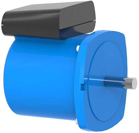

Image 1 illustrates what an ECM generally looks like, and it does not look much different than an induction motor. There are many synchronous motor technologies that can fit under this umbrella term; for a more in-depth exploration, refer to the Hydraulic Institute’s article, Driver Technology for Variable Speed Applications, at pumps.org.
