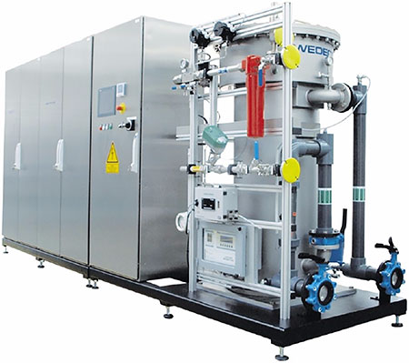

Ozone is unstable and so will react and oxidize with most organic material it comes in contact with, thereby destroying many pathogenic microorganisms. Ozone is considered a safer means of disinfection than chlorine since it does not create any byproducts or residual chemicals in the water. Ozone can also be generated on-site if required (Image 2) rather than having to store large quantities of chemicals, such as chlorine. However, the cost of ozone generation equipment and trained operators can be high.

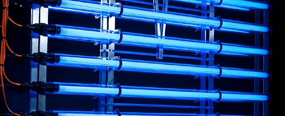

UV light can be used for effluent disinfection. Because no chemicals are used, environmental impacts from the disinfection process are reduced. UV radiation causes damage to the genetic structure of bacteria, viruses and other pathogens, making them incapable of reproduction. In a typical UV system (Image 2), the wastewater flow passes across the lamps using gravity flow. The effluent needs to be highly treated to ensure the target microorganisms are not shielded from the UV radiation by solids in the stream.
